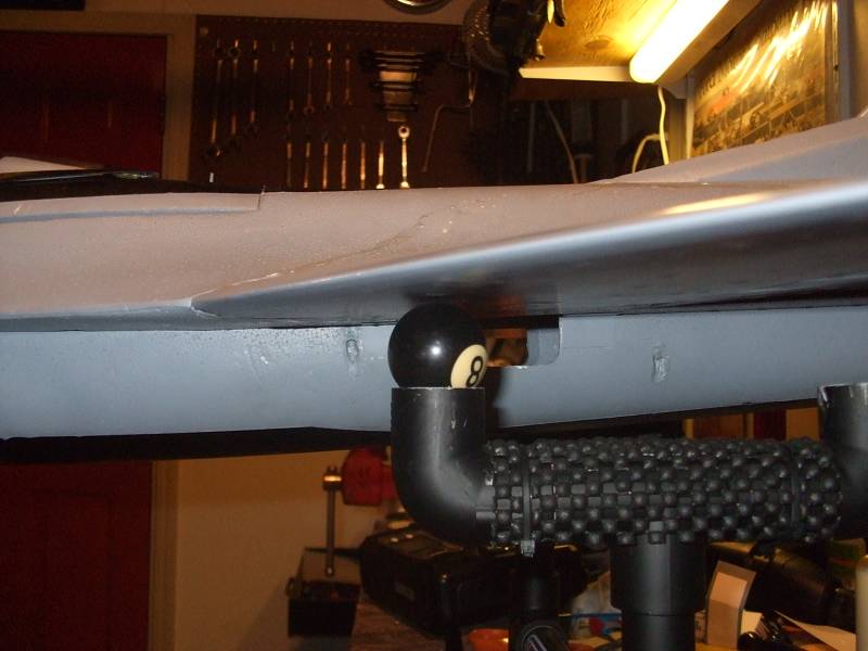

I accidentally found the use for this when I was desperately trying to set the cg on my f-16. I was having trouble using my fingers to check the cg on this plane. It has worked fine with my larger planes. I needed something to set it on, but can't afford to run and get the great planes cg machine.(which is what I really want) I looked up on my shelf and saw my monster truck work stand and... [sm=idea.gif]! I placed two racquetballs on it at first and set the plane on it till it was balanced. The raquetballs were a little too large to see the spot on the planes fuse, so I found some smaller marble type balls (8-balls), and they worked great. I could see where it lined up on the fuse and measure it. I set the cg and she flew great. The stand also functioned well as a work stand since the plane was small enough that the wings could rest on both posts of each side. It should work well on my 40 size planes if I extend the vertical portion underneath the "goal posts".

Good idea!
Any tri landing gear of a 40 size model may hit the stand when balancing.

I'll try to extend the uprights high enough for trying the larger planes, and I'll put my trainer on there see if it works.
