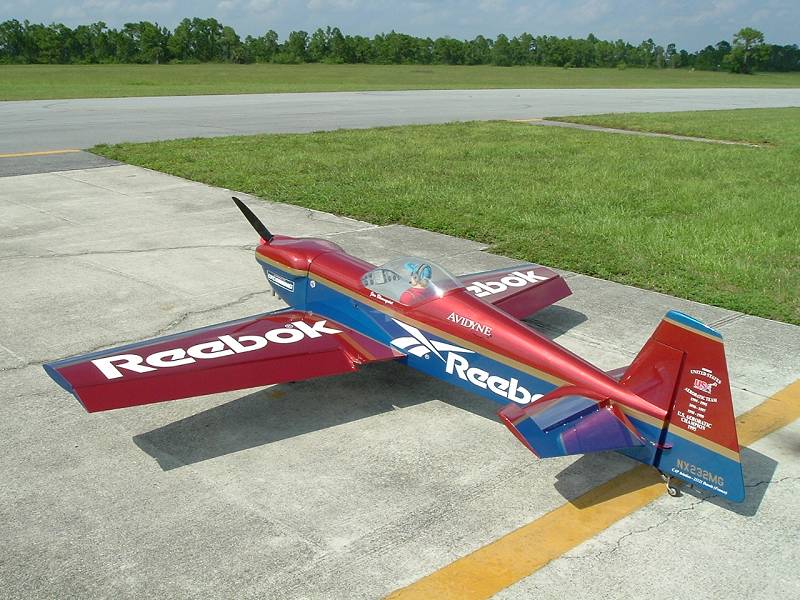

Ken,
You remember this ugly guy... This plane has been a cool thing for the stuff I do for Make-a-Wish, it was designed by one of their kids and is a huge hit.
It's a Composite-Arf 35% Extra 260 using a DA100 on Canisters and Mejlik CF 24.5x12 CF prop and all controlled by a 12x dual JR9000 receivers and all all powr using 3 A123 2300Mah batts
The Da100 will rip that prop to no end, this is one powerful engine. Vetical, even with a 3-blade is unlimited, plane weighs 28lbs and has loads of competition time on it. Everytime I use it it gets me first place
I currently have a H9 Ultimate all being recovered in the same scheme as my 40% Cap232 below as well
