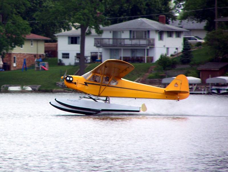

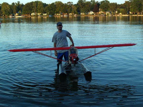

here are a few pics.. my 1/3 scale balsa usa j-3 with a 3w 85b2 cs twin! (non-scale knife edge flight with floats is possible)lol and the 1947 full scale j-3 n63061 (short take off , one float out, glassy water on rotation! flown by me)

i have not landed this full scale plane at the seamasters float fly, however it is on a lake in brighton...and i have circled the lake during the float fly
the balsa usa 1/3cub has flown at seamasters in 96 and 97 winning scale the 2nd year out, with and a 2nd the first year
