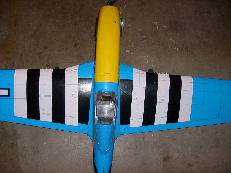

good question , I would like to ask another while on the subject. should i measure back from where the leading edge straightens out or right close to the fuselage ?

Allways measure from the wing root, where the wing meets the fuselage, unless the manual tells you otherwise.
Dont ask me how I found out that
