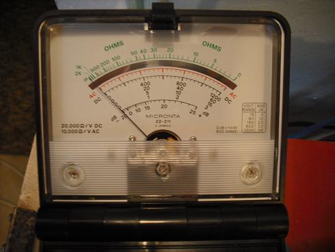

Anyone heard of this thing? Any good for RC planes? Anyone have a manual?

Looks like an older analog volt-ohm meter.
I used to sell meters but not to familiar with this particular one or most analogs for that matter. The analogs aren't quite on par with some of the digital meters out there but they are by no means useless. You'll find applications for it here and there on airplanes and plenty of uses outside of RC.
What you really need for RC though is a meter that applies a slight load for checking batteries between flights. Tower sells a simple expanded scale volt meter that does this and there are some nicer, more expensive units out there as well.

Looks to me if you know how to operate a Simpson 260 you know how to operate that meter.....I keep a meter on my bench for checking voltages, or continunity of a lead.
Chuck is correct though about the load applied for a snap shot of the battery at the moment you check voltage...
There are times when an analog meter is better than a digital.....

You can make any voltmeter (analog or digital) do the same job as a loaded voltmeter by just paralleling a load on the meter leads when you measure the voltage. Use a 10 ohm 1 to 5 watt resistor for the 4 and 5 cell batteries and a 22 ohm 10 watt resistor for 6 to 12 cell Nixx batteries. You do not need a load when measuring LiPo or Pb cells. IMHO buying a loaded voltmeter is a waste of money, you can have a more versatile VOM for the same money and have it do as good or better job of measuring what needs to be measured.

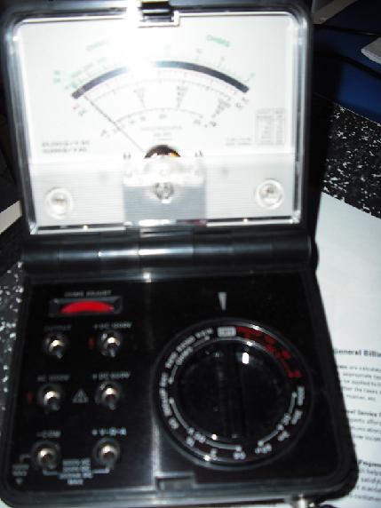

I have never used a meter before.
My main concern is lithium batteries.
I would like to learn how to apply a specific load to this meter.
I think potentiometer is one of the coolest words ever.
Thanks for all the information so far.

Here's a brief tutorial on how to use that meter:
Plug the black test lead into the "-COM" port, and the red test lead into the "+V-OHMS-A" port next to it. Then set the dial to the 15 setting in the "DC V" section of the dial (for batt packs less than 15V). Then you can read the voltage off of the "0-15" range of the DC section of the meter. If you are unsure of the voltage you plan to measure, it's best to start out at a higher setting and work down. So if you don't know if a voltage is less than 15V, then you should start with the 60 setting in the "DC V" section of the dial, and read the voltage off of the "0-60" range of the DC section of the meter. If that shows the voltage is under 15V, then you can drop down to the 15 setting and read the voltage off of the "0-15" portion of the DC section of the meter. To measure the battery voltages under load, simply connect the appropriate resistor across the test leads, in parallel with the battery. Rodney suggested some load resistors for different battery packs in a previous post.
There are 10 small tick marks between numbers on the DC portion of the meter, so that means each tick mark is 1/2 a Volt in the 15V range setting, 2V each in the 60V range setting, etc.
Hope that helps!

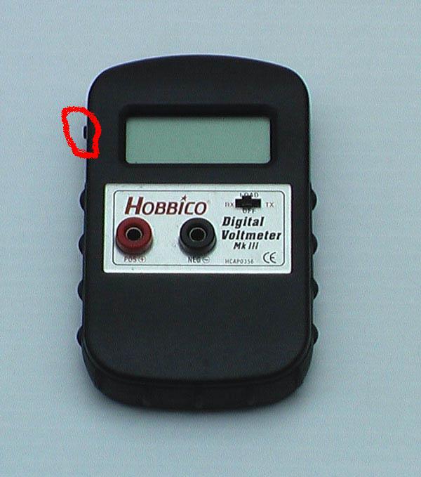

Do you know what the (stupid) funny thing is here? I got a Hobbico digital ESV for $5 at a closeout sale. I thought it was old and defective 'cause it wouldn't turn off. You put the switch on the front to "OFF" and the unit doesn't turn off.
Today, I found this:

Those things happen. I still forget where the power button is on my Blackberry.
