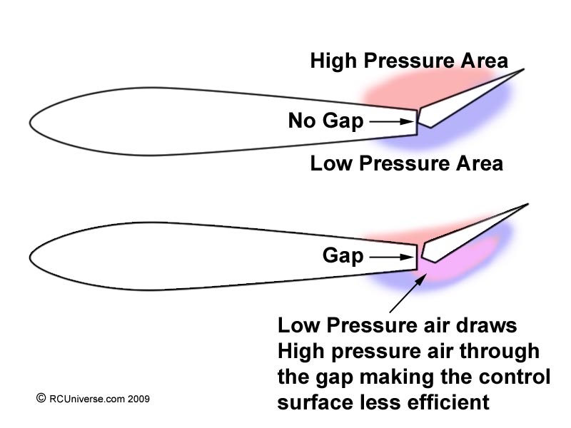

Ok, here's why:
When you deflect a control surface UP, the surface creates a high-pressure area on the top side and a low-pressure area on the bottom.
If there is a gap, the low pressure will suck the high pressure right through. This will make the control surface less efficient. In most cases, it's not too big of a deal, but I have seen people with a large gap talk about wanting more aileron throw and I tell them to seal the gap before they change anything - the next thing you know, they want LESS aileron throw.
I keep my gaps small and haven't sealed one in years, but if you're performing precise areobatics (Like pattern fliers do) you would want to seel it - not so much to make them more effective, but to make them equal to each other.

MinnFlyer's a great source of knowledge... and he has a picture for everything.
Just make sure when you've sealed your gap you still get full flex from the control surface. Best way to achieve this is extend the surface fully downwards then seal the top, then flip the plane and reverse the process so the two layers of sealing medium actually stick to each other through the gap along the hinge line.
