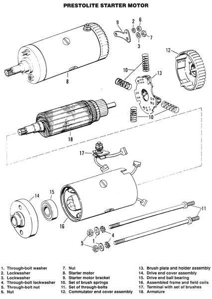

I found this diagram of a small motorcycle starter, while a bit larger and I am sure different, almost all of these starters are very close to what you see here.
Should give you an idea and get you within the ball park anyway. GOOD LUCK
