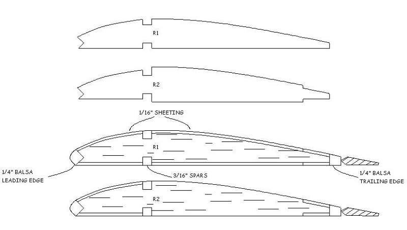

I need to repair the leading edge of my trainer. Where can I find the L.E pictured in the attached graph? Needs to be 1/4"hx3/8"v

Use 1/4"x1/4" square balsa and sand it to shape.

Some LHS have pre-shaped LE material.. but where is the fun in that ! I'm assuming this was an ARF? Be sure the ribs in and around the damaged area are good as well.. look for lengthwise slits down the rib, etc. that aren't noticed until you give them a lil tug.
