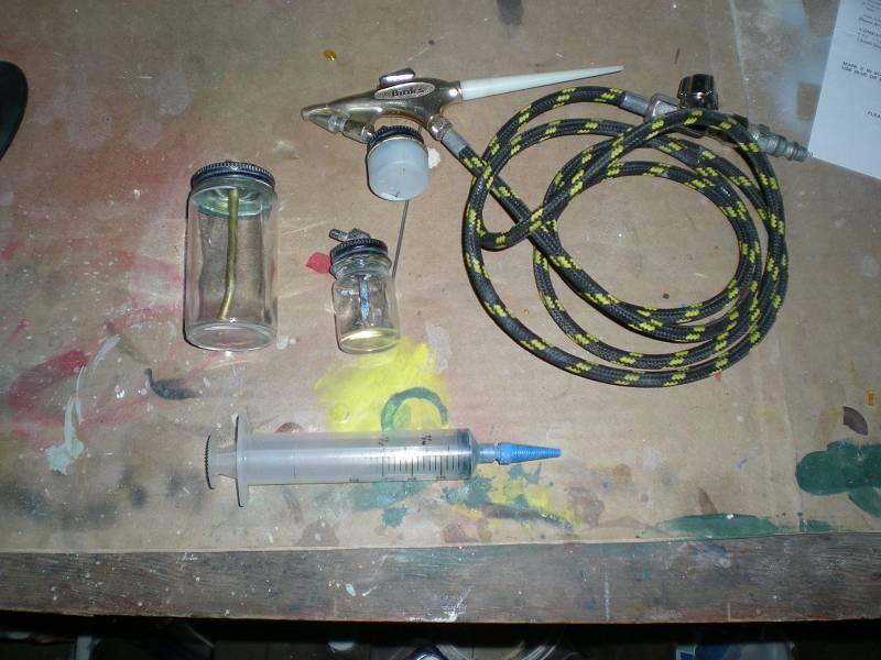

when I am doing any model paint work I use a graduated syringe to draw the paint from the can and thin for spraying, when I am using water based materials, which is most of the time now so I can get accurate ratios for spraying.
when I am spraying models I use a higher end airbrush which takes a little less material to get it working, and it has a little more product control,but those guns work great as well its a learning curve.
