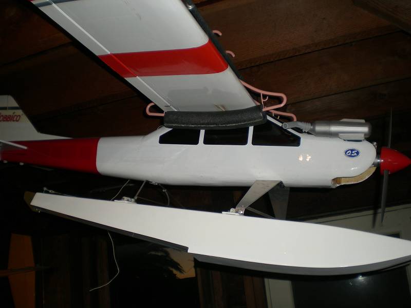

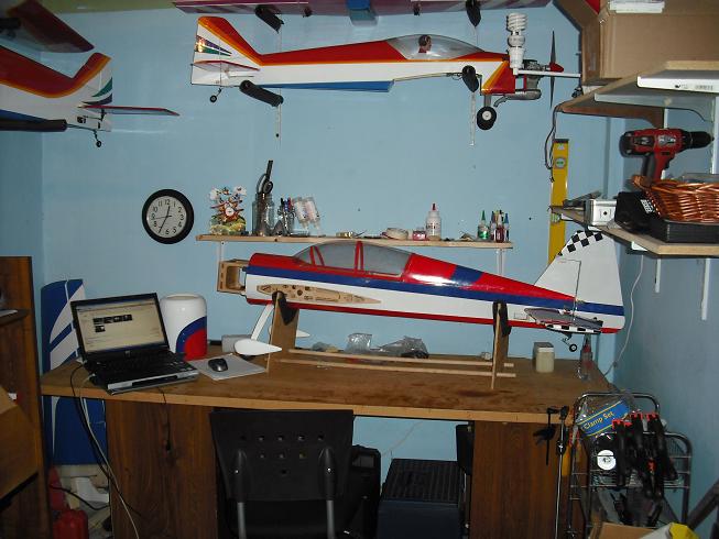

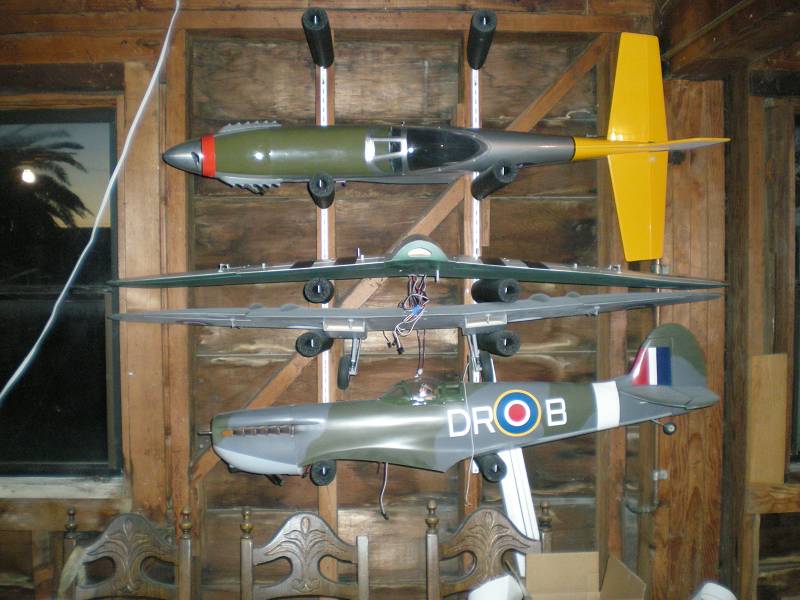

I use several types of storage methods since this topic comes up about once a month, I happen to have photos
first would be the shelf brackets, for which the plumbing insulation works well for padding, its a versitile method for storing wings, fusalage,and other parts safely, while preventing any dammage, and just getting the planes up and out of the way of my building areas.
the versitility of the brackets is really handy to adjust for the various sizes of planes.
also another method is to use a plastic hangar, again utilizing the foam insulation for padding to hold the plane up to the ceiling the hangars slip over the wings and, in my case slip over the electrical conduit but a couple of hooks screwed into the ceiling would work fine as well.
having a large shop is handy,and my storage is spread out a bit, but if your space is limited then using both methods in a small space can allow several planes to be stored easaly.
