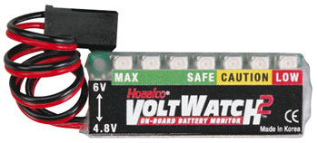

Brownout is a reboot of the rx,in a low voltage situation these rx's reboot causing a disconnect called brownout buy one of these and it should not be an issue 4.8 or 6v .
http://www.rcuniverse.com/forum/post...750&toStyle=tm

That wont happen if you use a battery capacity that is appropriate for the installation and check the battery before each flight with a loaded volt meter. I personally wouldn't bother with a voltwatch.
Bingo! The browouts stem from current drain in excess of what the battery is designed to handle (which temporarily depresses the voltage), not from 4.8V batteries in general.
The gentleman that helped you at the hobby store is mistaken. Receivers can handle a 6V battery, but as mentioned, some servos have trouble with a fully charged five cell battery. If this happens, you can always use a regulator. Keep in mind that a five cell battery of the same capacity will not last as long as the four cell but will give your servos more speed and torque.

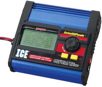

Ok so i am to understand that a 5 cell 6v 2000mah battery pack is just fine ? can anyone suggest a good charger that will cycle my battery as well ?

Depends on how much you want to spend. I have an Accucycle, Triton, and an ICE. All do just fine. Don't rely on the wall-wart type charger for the 6 volt battery. Some say it will work, but I have my doubts. It was designed for 4.8 volt cells no matter what some may think.
Of the three that I have, the Accucycle is the easiest, but I feel that the ICE is the most useful, does all sorts of batteries.

I really like the Accucycle Elite: http://www3.towerhobbies.com/cgi-bin...&I=LXEYD4&P=ML
Another good option for less money is the Accucell-6 from Hobby City. The main problem is that it is DC only so you'll have to get a power supply if you want to run it off of AC house current. The price is hard to beat. Looks like they are out of stock though.
http://www.hobbycity.com/hobbycity/s...lancer/Charger
http://www.hobbycity.com/hobbycity/store/uh_viewItem.asp?idProduct=7373&Product_Name=Turnig y_Accucel-6_50W_5A_Bal/Chrg_(USA_Warehouse)
