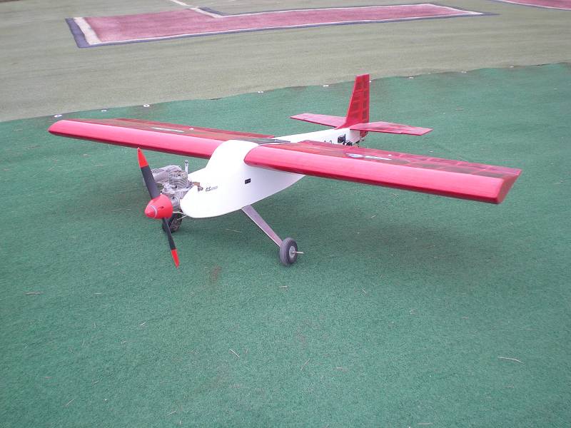

I used a set of these GP gear on my Gizmo so I could have a little bit wider wheel base than the stock gear.
I also used them for my float plane conversion of my Nextar as well, the float plane needed a cross bar to strenthen the gear sisnce they were so bouncy.
there very light weight to start with so I am not sure if lightening holes are going to be all that much of a benifical.
there also made from soft aluminum and are really flexable, mine have started to splay out a bit and need to be bent back into shape by drilling holes in the gear I really dont know if your going to save all that much weight for the weakening of the LG that you will have done to them, if your going to drill holes in the gear I wouldn't make them all that big

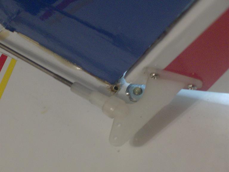

Any suggestions are certainly appreciated w8ye..... the elevator rod comes straight out the middle of the rear of the fuse, the rudder linkage comes out the top of the other side of the fuse to the rudder.....and the hinge line for the elevator is about a quarter inch behind the rearmost part of the bottom of the rudder....

There a couple ways to skin that cat
The main solution is that there has to be a torque tube going up through the fuselage that is in line with the rudder hinge line. In other words run a brass or aluminum or hard nylon tube down through the fuselage that goes to one side or the other of your elevator control rod and out the bottom of the fuselage. It has to be on the center line of your rudder hinge. It will have to terminate on the bottom into a piece of plywood. It can be 1/8" in scrap lite ply or some thickness maple ply.
There will be a piece of 1/16" music wire that goes up through this tube and up between the rudder and fin. It turns into the center of the rudder at a right angle about a 1/2" from the bottom and is epoxied into place. The bottom of this torque rod will be bent at a 90 degree angle to the centerline of the fuselage. (It will stick out to one side.) Use a connector such as these http://www3.towerhobbies.com/cgi-bin...?&I=LXD899&P=7 to connect a pushrod to your tail wheel wire which is bent the same way

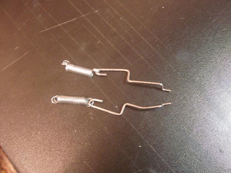

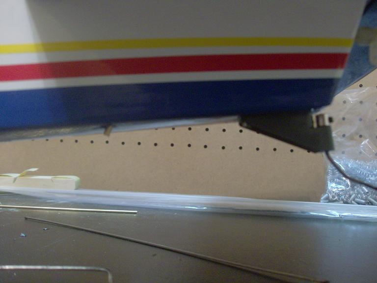

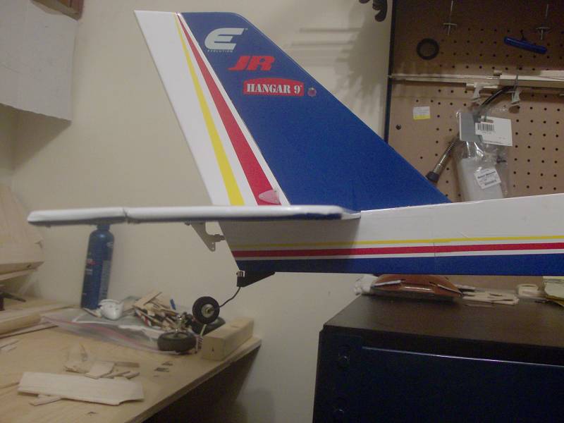

Well, after some trial and error I have a steerable tail wheel on the Arrow. I drilled a hole from the bottom up on the hinge line right next to the rudder hinge. I then inserted a brass tube into the hole and CA'd it in place. I first tried using a piece of sixteenth inch aircraft cable to link the rudder to the bellcrank on the bottom of the fuse but it had too much twist when the rudder turned so I replaced it with a piece of pushrod. The pushrod is bent at the top and captured behind the rudder tiller. on the bottom I fashioned a bellcrank out of a 16th inch collar and an old servo arm I had laying around. On the tail wheel I did the same thing with a smaller servo arm and on a hole closer to the tailwheel wire to give me a bit of amplification of movement. I tried using some springs in a pull-pull setup but the springs put too much tension on the tailwheel bracket and it bound up the wire so it was very dificult to turn. if I loosened the spring tension everything just got floppy and it didn't turn at all... I ended up just using a single pushrod from the front bellcrank to the back one. What do you all think about it????

The most important part is what do you think? How well does it work?
Looks pretty good to me

Seems to work okay on the bench, haven't had a chance to taxi around with it yet. It doesn't look like it turns enough buit that might be deceiving on the bench. I spoke to one of the fellas in the club here and he put me on the idea. I came up with the design and put it together. I'm sure if it doesn't do what I want I can try something else to get it right.

you did what I had in mind
The proof is is the flying. You may want to change the ratio between the belcrank and the tail wheel?
