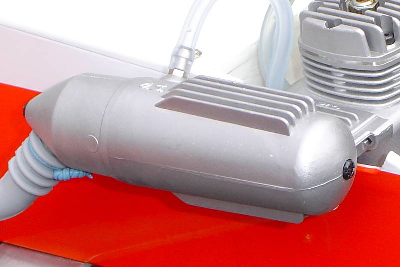

any suggestions on a possible way or type of adhesive that might help. I'm going to zip tie it but thought if i added some sort of adhesive, it might help. what do you guys think ?

The most important part of keeping the exhaust diverter on a muffler is to start off with a clean surface, free of oil, and a clean exhaust diverter, AND, of course, to get the right size for your engine. You don't need adhesive, and most will melt or de-bond with the heat.
I have Dubro exhaust diverters on all of my planes, not a one has come off at any time. This is because I did as I suggested, AND used two zip ties in the slots provided. You have to pull the zip ties tight, use a pair of pliers then trim them close. If you break one by pulling to tight, well, remove it and put a new one on. Use the small size that come with the diverter because they are the most flexible and will wrap completely around without having gaps. Again, if you break one, remember how much you pulled it together and put another one on but not quite as tight (common sense stuff).
You only need two zip ties and put them in the spots shown by the manufacturer. I have only used Dubro and they all come with two slots or spots for the zip ties.
The key thing here is to make sure your muffler exhaust port is clean. Use alcohol to get ALL of the oil off and wipe it dry. Check it to make sure oil did not dribble back out on the surface. If it did, clean it more. Depending on the muffler (OS 70 AX for instance has OS Power Box mufflers that come apart), you can disassemble the muffler, clean it really well, then install the deflector first, then put it back together.

The trick to tightening a zip-tie is not to pull on the tail, but to place a long-nose pliers against the retainer and rotate the pliers to pull the tie end out. (It doesn't always work!) One alternative that has been somewhat more secure is to wrap two turns of electrical hookup wire (solid wire, insulated) around the exhaust diverter and then use the pliers to twist the ends very tightly. Not a guarantee, though.

I like to take a cutting wheel in the Dremmel and make a shallow groove in the muffler outlet. Then make sure one of the zip ties is over this groove. This will give it something to get a hold of.

A slight bead formed around the outlet tube with JB weld (not much more than a bump) just behind where the zip ties go. Works well even if you have a fit too loose on the outlet pipe.

When I put mine on, I clean the surface real good with alcohol. Put it on with the zip tie as tight as I can get it with a needle nose pliers. Then wick some thin CA. Haven't lost one yet. And when it comes to removal, it will pry off with some persuasive twisting.

If you use a razor blade to score the muffler tip all the way around it about 3 times, one ziptie will work. The cuts give the deflector something to grip, and definitely clean it first. I've had mine on with on ziptie for quite a while, and I can't even rotate it after its in place. If you want the end all solution, go to the auto parts store and get the small hose clamps for it. They can be tightened up a lot and you can practically hold the weight of the plane from the deflector.

happy to report nice and tight, cleaned w/ alcohol and tight zip ties . Flew about 6 times today, did notice about a 15 % reduction in power. thinking of cutting a inch or two off the end, maybe.
