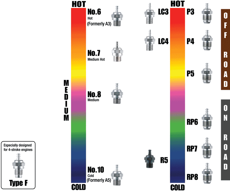

Hi guys,
I'm pretty sure this one has been asked a million times, however in my search i can't find where it's discusses on here.
I'm going to get my first glow engine (trying bigger than electric planes for a bit see if i like it) but I can't figure out which glow plug i need to get
the engine will be an OS LA40 or Tiger .46 what do i get? #8 long, short, cold medium heat or hot glow plugs? too many options I'm stuck
I live in the tropics and tempretures over here are around 27-32C (80.6-89.6F) most of the time sometimes slightly higher by one or two degrees anyone got any opins on this?
sorry if this has gone round here too many times to count but I'm in a bit of a rush to make an order and can't spend a couple days digging into the forums properly.
Thanks for any consideration guys.

The basic OS 8 plug is just fine for that engine. I'm sure that there will be others with varied recommendations.
What plug came with yor OS 40 LA? I would duplicate that, most likely it's an OS-8.

Yup. That will work just fine. Now, if you are looking for a shopping list, you can always pick up a few spares, and one or two spare plugs in other heat ranges. See the below chart.
CGr.

Short glow plugs are for smaller engines with less clearance between the cylinder and the head. I'm not sure where the cutoff for a long plug is, but it's smaller than a .40 so you want long plugs.
OS8 is a good standard. You can use a hotter plug for cold weather, for fuel with little to no nitro, or if you want to improve your transition and don't spend a lot of time at wide open throttle.
Colder plugs if you're using higher nitro content, if it's really hot or your engine is running hot, or for larger engines. My 1.20 comes with OS cold plugs. Large engines have more material to hold heat and thus do not need as hot of a plug.

CGRetired suggestion is right on the money.
The LA loves the "8" plugs and will not benefit from a longer plug.
I run an "8" on mine and I have yet to have a single deadstick on the LA .46.
