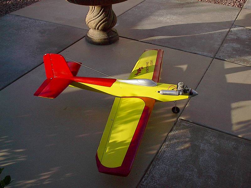

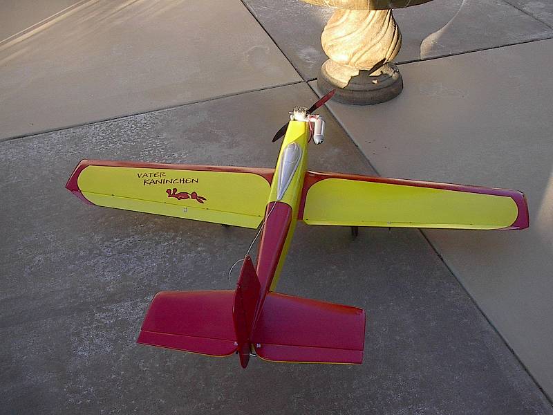

This is one of the little things builders can do that those that have only flown ARFs will never be able to do,build a free airplane.
This is a Daddy Rabbit designed in 1966 and won the class 3 pattern Nats. Iwas given the blue prints, had the left over wood from other builds sitting on my shelf, all the hardwood stringers I cut out of scrap hard wood i found in my wood working clubs left over bin. Ieven ripped the wood for the landing gear blocks with a groove in them.
The only money Iused was for the front steering LG system and two cans of spray paint and one can of red that I used my spray gun with. The primmer I had from when I was painting my old pick up truck.
Engine is an SK .90 Ihad under the bench, servos are a mix of Hitec 5475s and 475s with a Futaba RX. I used a HS 80 for the throttle and an HS 81 for the steering that I have slaved to the rudder, easier then running control rods.
Idid run out of little things like CA and had to go to wood glue, Ieven used the last drop of epoxy Ihad. Iended up having to pull some clevises off of an old plane, I'm even out of those little things.
It's all ready for the maiden now.
Ihave been walking out to my shop and looking for things to do on and off all day. It's building withdrawl. My god, I even put my tools away and swept the floor. Ihave more wood left over!! Ihave a closet full of plans, should I try to build another free plane or install an engine and gear in one of my old wall hangers?? Maybe fix one of my planes that is need of repairs?? So many choices, Ithink Iwould like to be flying but the weather looks like crap for a few more days!!
Oh well, something will come up.

No Ididn't use glass, Ishould have but I wanted to try something. Iused sanding sealer then water based Poly-U but left out the glass. Iused three coats with 50% Baby Powder in the poly thinking it would fill all the grain, not so!!! From now on Iwill stick with glassing.
Thing is I have plenty of left over 1/2 oz. glass under the bench too!!
That would have still been counted as free!!

By the way, they are the Bridi Kaos, Tower just got the rights to have them made, Tower used to even sell the 60 size and the 40 in kit form. Just a point of intrest.
The DR was designed for higher wind conditions and flew in 1966, the Kaos was designed in 1970 and won the Nats three times, the DR only once.
The DR is also shorter coupled and the tail feathers are different shaped. Until I fly the two of them one after the other I'm not sure how much different they will be.
You will also notice that all the classic pattern planes look very similar in design and shape.
One other thing, they all fly beyond great!!
Take a little peek at the Ultra Sport, take note of the wing and stab shape then figure out whaer it came from. The US has a much better fuse shape though.
Next time Ihave the Kaos and DR side by side Iwill try to remember to take a photo of them together, you will notice a lot of little diffenences.
