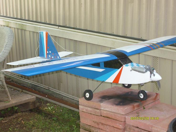

All you need for the wings on that bird is a 25 dollar hollow core door, and a 24x48 inch acoustic tile from a drop ceiling. I'vebeen using this setup for many years without problems. Now if you graduate to a symetrical wing, try the Magic Magnet building system. It has clamps,step blocks and everything you need for perfect wings.
Keep your head up on a swivel.
