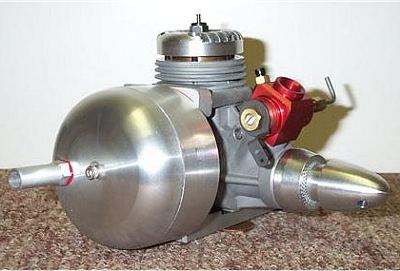

Ro, check out this Jett muffler. It's quite small. They make adapters for various engines too.
