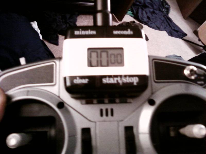

One more thing that I would recommend is a cheep cooking time $5 at wal-mart.the last two times I went up me and the instructor flew the plane outa gas. normily this is not a big deal but the last one he had me practicing finals, the plane dead sticked halfway down the runway and 20ft. I got lucky that time, if it had deadsticked 5 seconds later it would be in the old cornfields!

Most computer radios have built in timers - my Spektrum's can be changed between a stopwatch and a countdown timer. Set up your glow plane on the ground, run a full tank through it at full throttle and see how long it takes to die, then program that figure into your radio's timer (or keep track of it in a notepad and use a kitchen timer as RegFlyer suggested). Since you're very unlikely to fly the entire flight at full throttle, that gives you a minute or two once the timer goes off to get into position to land.
Then you just have to remember to start the timer counting when you take off.

True about the DX6i and up, i have a DX5e. if you dont get a comp radio then cooking timer is the way to go

Cheaper yet - go to the Dollar Store and get a cooking timer there. Then break off the magnet/clip on the back and epoxy on a clothes pin, so you can clip the timer to your antenna.
The Alpha 40 RTF package comes with a DX5e, which does not have a timer, so you will need to get yourself a cooking timer to be sure you don't run out of fuel.
