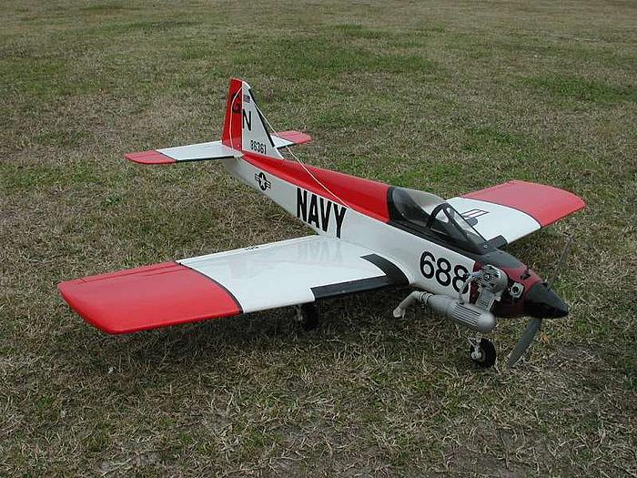

Hello guys, I kind of know the basics of the props, my situation is the following,
I have an extra 330L from nitroplanes with a 46AX and pitts muffler, my plane is heavier than average, not that much, but still, anyway.. I am currently using a 11x7 prop and it took me a lot to take off, when I started to climb, I had to pull elevator very gently while the plane gained speed, once it was on the air, the plane was a rocket, flying very fast even at 60% throttle, however, when decreasing below 50% throttle, the plane does not seem to have enough power and it looses altitude during turns.......
I also noticed that when landing, if coming too slow the plane just seems unpowered and one of the wings stalls......
I was thinking that if I changed to 11x5 (or 11x4), this would give less top speed to my plane but maybe would make nicer the low speed landing approaches??? However, I am not sure and that is why I would like to ask to the experts of this hobby, given my case what prop is recommended???? My plane (extra300!) can not float, reducing speed makes it stall and then due to the prop (I guess), my plane does not speed up fast enough to recover, I have been lucky to land it without problems but I do not like that feeling of the plane tending to stall while approaching to land if I reduce speed too much......
Opinions please....

To reiterate what has been said above, fly and try. This is the only way you will know what prop flies your particular airplane the best. When you get a similar airplane and think the same prop will be the best, maybe so. But it is still worthwhile to do a little fly and try. I've been surprised several times.
For a long time, the 11x7 was considered a good starting point for .61 two strokes. Over the last several years, more and more people say they are running them on .46 engines. My brother had a TT46Pro on a Big Stik 40 and the prop that he felt gave the best performance was an APC 11X5.
Like gboulton wrote, you have to experiment to find what YOU like because your opinion is the onlyone that counts when it is your plane and your money involved.
Matador
It sounds like you have an airplane with a high wing loading and possibly under powered. If the numbers I got off their web site are correct, your airplane has a wing loading of around 31 oz/sq ft. For a 40 sized model that is extremely high. So expect a model that has to be flown to landing at a rather high speed.

thanks for the inputs, the manual recommends 11x6-11x8, that is why I have always used 11x7 for this engine, I had before a mustang pts and an edge, and they flew great with it, but as you said, this plane has lots of weight for the engine size......... do you think that the 11x5 would be too low? why does not the manual recommend it??? I would like that this plane would fly more solid at low speed and that is why I was wondering if a prop with lower pitch would help or if that would not improve the plane stalling at low speed.... would not a lower pitch prop help it to float a bit better?????
For take off, the plane really needs lots of speed to take off..... would a lower pitch prop would make it take off in a shorter distance at lower speed???
I'd try the 11-6 first and see if the engine increases it's power output. However, changing the prop is not going to change the stall speed of the airplane. Only reducing weight will do that.
