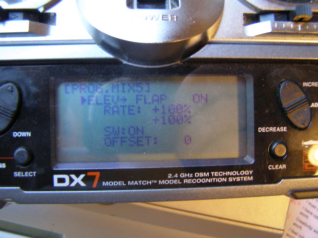

My fifth plane is a Edge 540 with two servos on the elevator, could someone guide me through setting up my elevators using a program mix. I have a spektrum dx7 tx, and I'm using a 9 channel spektrum dsm2 receiver.........I was told to use the # 5 or #6 mix, but where do Iplug in my two servos...........one in the elevator slot and the other?...........or do I use a y-harness, or , or, or ............help!!!!!!!!!!!!
I was previously using the AUX 2, and and the elevator channels, but I could not adjust the control throw on the AUX 2 channel..................ready to maiden.......help!!!!!!!!

Yes, you want to use the #5 or #6 mix. With these two, the trim for the master channel also trims the slave, this isn't the case on other mixes.
Plug one servo into the regular elevator spot and the other into Aux-1 or Aux-2.
When you set up the mix, make elevator the master and Aux-1 or Aux-2 the slave. You can control end points and the direction of elevator and your chosen slave channel as needed to get the elevator working correctly. Make sure you set the mix at 100% in both directions.
I believe you also have to disable the switch for the slave channel but I don't remmeber off the top of my head. I can look at a couple of my setups this evening.

connections are to elevator slot and aux 2. the servo going to the elevator slot works fine, but the servo going to the aux 2 slot operates in only one direction, how do I change the direction of the aux 2 servo.

Just go into the reversing menu and reverse aux-2. You can reverse every channel on the DX-7.
Edit: Just re-read your post and see what you are saying. I'll take a look at one of my setups. if not tonight, definitely tomorrow. I just can't remember off the top of my head.

OK, here is what I've been doing...
1- From the main menu where you program the name of the airplane and stuff, disable the switch for the slave channel you are intending to use. In my picture I have both the flap (aux-1) and aux-2 channels set to INH since I'm using both dual elevator and dual aileron servos. Doing this insures that bumping the switch won't affect one of your surfaces.
2- In the regular adjustment menu turn on mix #5 or #6. Select the elevator as the master and the desired channel as the slave. In this case I am using the flap (aux-1) channel for my second elevator servo so I have flap set up as the slave. Make sure you set the mix percentage in BOTH directions. In my case the linkages were dead on so 100% in each direction did the trick.
If you need to reverse one channel, just do it in the regular reversing screen. You can also control end points for each elevator channel separately to fine tune everything althoug I'd do it as best possible mechanically first.
This may not be the correct or the best way but I know it works.

Thanks everyone for your support and info.............I now have functioning elevators using no. 6 mix, as of last night...............looking to maiden Saturday morning.
