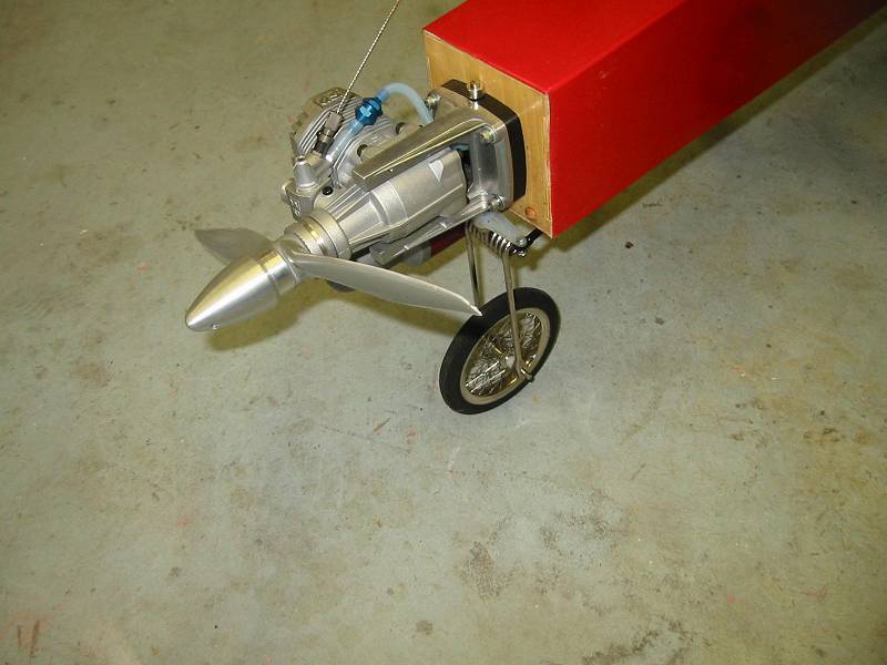

Default RE: Just picked up a GP Big Stik 60! Engine Recommendations?
OS AX 75, Fults 5 inch dual strut nose gear, Top Flite 4" spokes all around and a Jett Stream muffler.
It's a blast to fly!!!

I'm not familiar with the SK's but 15" seems like alot of propeller. I've had real good luck with the Top Flite wheels. They're about 4.5 " in dia. They're metric hubs so you need to "carefully" run a drill through them. The hubs are made of brass so they cut easy. The spokes kinda go with the World War One Eindecker/Stick and they don't catch alot of wind as they have a narrow profile and being spokes there isn't much of a side profile either.
The Fults tooling nose gear was one of the best things I've done for this model. It's super tough. I used the OS engine mount and cut out a piece of Plastic Delrin that mates to the stock fire wall blind nuts. If (When) I tear one up I can swap the whole front end in a jiffy....
I also went with real good hardware/horns/carbon pushrods/etc. that can be re-used and transfered over to the next victum.
One of the best things (I think) about the GP sticks are the replacement parts, much less exspensive than the Ultra stick parts. I tend to get "over confident" and buy extras. But that's how you learn right.

As a 60 size plane probably none at all. I try to get about one inch of clearence between prop and ground. My last build is a trike geared plane, my first one, I have always built tail draggers. I have about one inch of clearence and haven't had any prop strik problems so far but maybe using a Master Airscrew prop would be in order at first? I use MAS for trainers where I know there will be a lot of strikes and so far haven't broken any.
My plane was built from plans, a 60 size pattern plane and I bought the longest aftermarket frone LG as I could find but it just said 60 size on the package. Can't remember the make. The stick should be OK. Look up the specs on the plane and see what they have for clearence, you may need some bigger wheels/tires? Or you can use a three blade 14X7.
