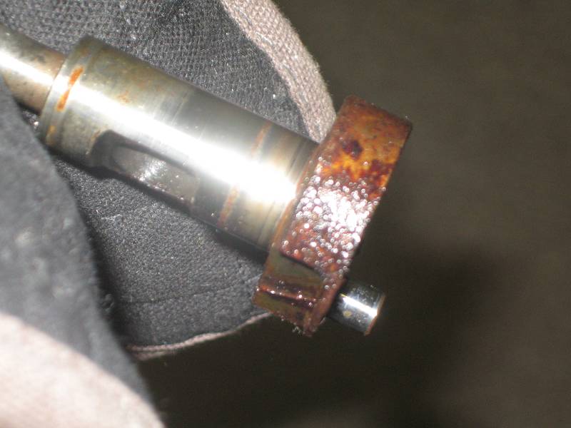

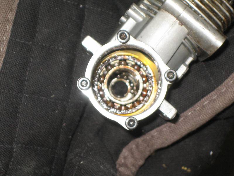

Hey, I just found out the hard way why after run oils should be used. I bought a plane off a fellow member, and it came with a used GMS 47. It ran great for about 3/4 gallon of fuel, then i started having problems. At first, it was making a weird sound at low throttle settings. Then I had a deadstick on the down line of a hammer head. (it died when i chopped the throttle) and today, it just quit. half way through the flight. I never had a lean run, and initially suspected dirt in the carb. when i went to turn the engine over, it was really tight. It always had great compression, but it was tight all around. I just tore it down, and found the bearing in the very front of the engine had failed. The crank shaft was really rusty and corroded.
My guess was that this engine had been sitting for a long time without any oil in it. The fuel i use says not to use after run oil, but i do anyways.
So for anyone new to the hobby, or anyone who doesnt use after run oil, this is what will happen.

ORIGINAL: andrew66
No, that's what CAN happen. But it can also happen if after run oil IS used. It depends a lot more on how the engine was stored.

dont chuck it out (if you are going to send it to me ), wd-40 the heck out of it that should get most of the rust/junk off the crank (let it soak for over night) , then get new bearings (may be able to wd40 those as well, but prob not, its worth a try) and you should be good to go.
is your conrod/piston rusting at all?
i cleaned a engine, that looked similer to yours. only it was a bushing engine
i dont use after run and none of my engines look like that

The engine is junk. The bearings arent just rusted, the front bearing is in little tiny pieces and there were balls just floating around in there. I have a webra 40 for 3 years now, and always used an after run oil of some sort. In winter, I plug the exhaust and carb after a good healthy dose of oil, and it has no corrosion. This is just unacceptable. I could see a bit of rust forming, but not to that extent. In manitoba, it is really humid.
I am also aware of Omega having after run oil (actually just rust inhibitors) that is what i run in my engines.
I bet that the engine was just run all season, then stashed away in a closet or shed for the winter.
Pilotfighter: The engine came with the plane, and two servos. I bought it for $20.00 (the guy really wanted to get rid of it) The way i see it, is im still ahead. I have a ST GS 40 that i got for xmas in it now. Its actually a pretty good combo.

That engine isn't in bad shape at all. A new set of bearings can be had for about $20. Clean the rust off the crank shaft to prevent any rust from coming loose. Look closely at the cylinder sleeve and piston. if there isn't any scorng of either, it shoud be good to go. Or you can put a new piston, sleeve, and connecting rod in it.
The kind of rust you're seeing on that crank is not what one would see from a few weeks sitting in storage. That looks more like an engine that has been sitting for a few years in a humid environment. Under those conditions, even after run oil can be challenged. If the crank case is not closed off, moisture will build up due to temperature, pressure,and humidity changes.
Whatever you do, don't just pitch the engine out. Give it to someone that is willing to repair it.
