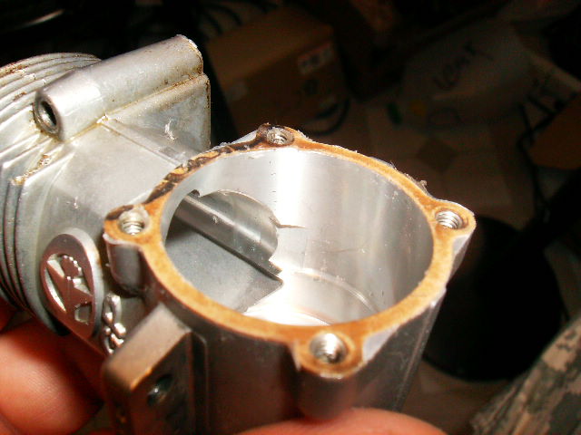

I have had 2 GP42s that responded well to a little porting and polishing. I don't have the original muffler but I have been using an OS 40 size muffler without the baffle. I imagine a pipe would work great. I really like TT engines, I have several. It's great fun to tinker and with an inexpensive engine you are not out much if you slip up. (loser engine????)

Some examples of the porting
I just ran it with a Master Airscrew black and got 13,500 on a 10X6. Using Sig 15% champion fuel and a Hanger9 medium plug.

RC engines work on the same principles as their grown up cousins and will respond to mods in similar fashion. They are mostly air pumps you know.
The trick to porting is just looking at the way fuel and air mixture flow, it doesn't like sharp edges or quick turns and it follows a smooth surface better than a polished surface. Also a polished surface will cause the fuel to become separated due to a loss of surface turbulence that keeps the fuel mixed, this is called "drop out". I have ported and polished from small RC engines to motorcycle engines to big V-8s with excellent results.
