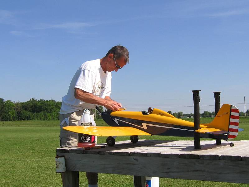

I used the plastic one. Tried painting it but looked terrible so I just covered it with monokote. I cut the monokote from the bottom edge of the headrest and epoxied it onto the fusalage.
Then I put small rubber black tubing up around the front of the headrest (the upsidedown U area) and along the inside rim area of the cockpit and cemented that on with RC 56 glue. Holds great.
I didn't use the flimsy plastic windshield at all.
My pilot Lulu is starting to look a little rough but she gets the job done. If you been through all the abuse I have put Lulu through, you'd look a little rough too! My camera makes the colors look awful when I take pictures inside!
Opps...mine isn't the hog bipe!

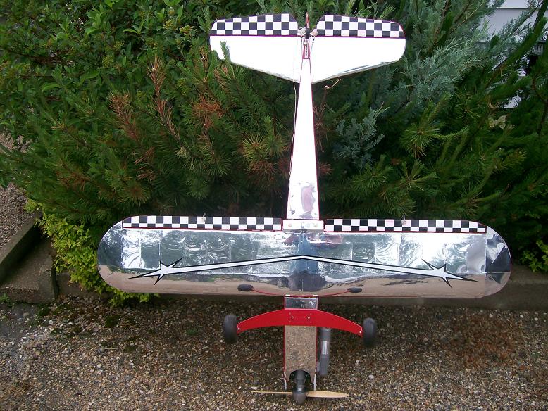

Thanks for the compliment. However, it didn't look so great the day I wiped out the front end and busted the wing in half. Had it back together in just a couple of days beleive it or not. You could never tell it ever happened after the repair.

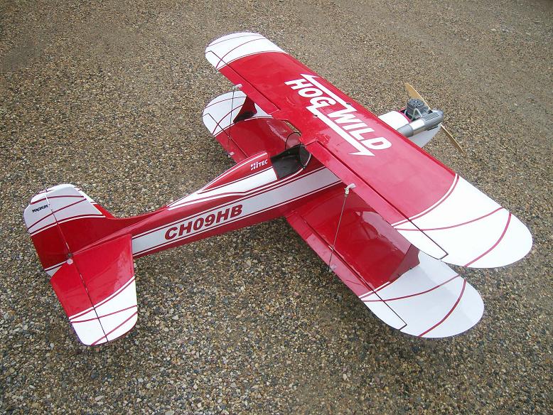

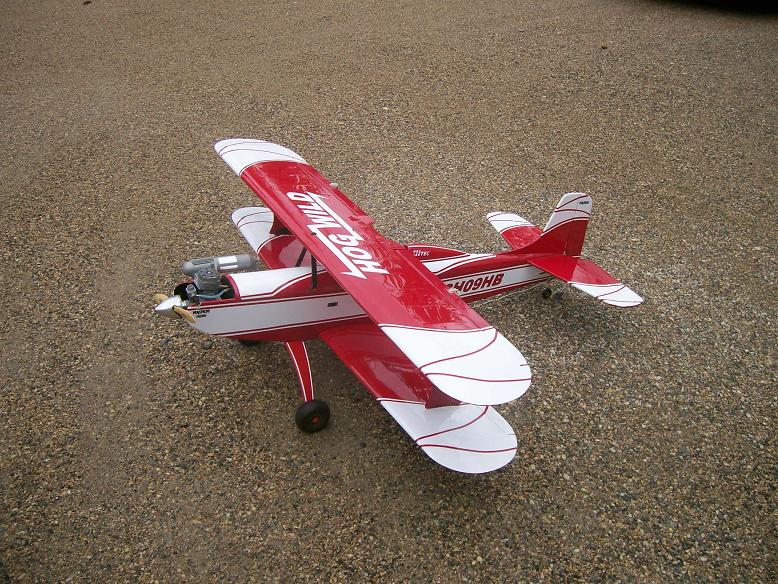

I rebuilt this one from a garbage can plane. I reused the plastic headrest. I glued balsa plugs into the hollow cavity on the underside of the headrest, sanded flush, then glued onto the top of the fuse. I decided to paint the headrest rather than cover it because the color matched pretty good.

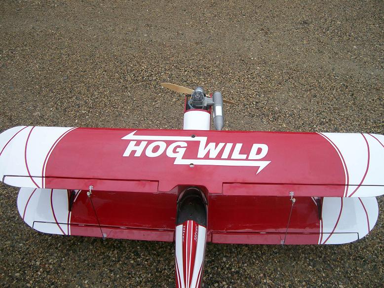

If memory serves, I glued a few small balsa blocks on the fuse and then glued the pre-painted head rest on the fuse. Pics attached (I hope).
