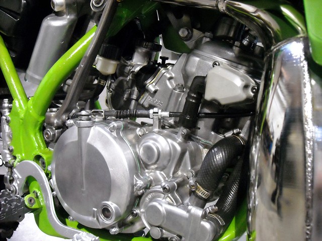

Expansion chamber just like an old school 2 stroke dirt bike.

I don't know what that means either. Does it add power? or noise? or both? or neither?

ORIGINAL: Flyin Beagle
http://en.wikipedia.org/wiki/Expansion_chamber
