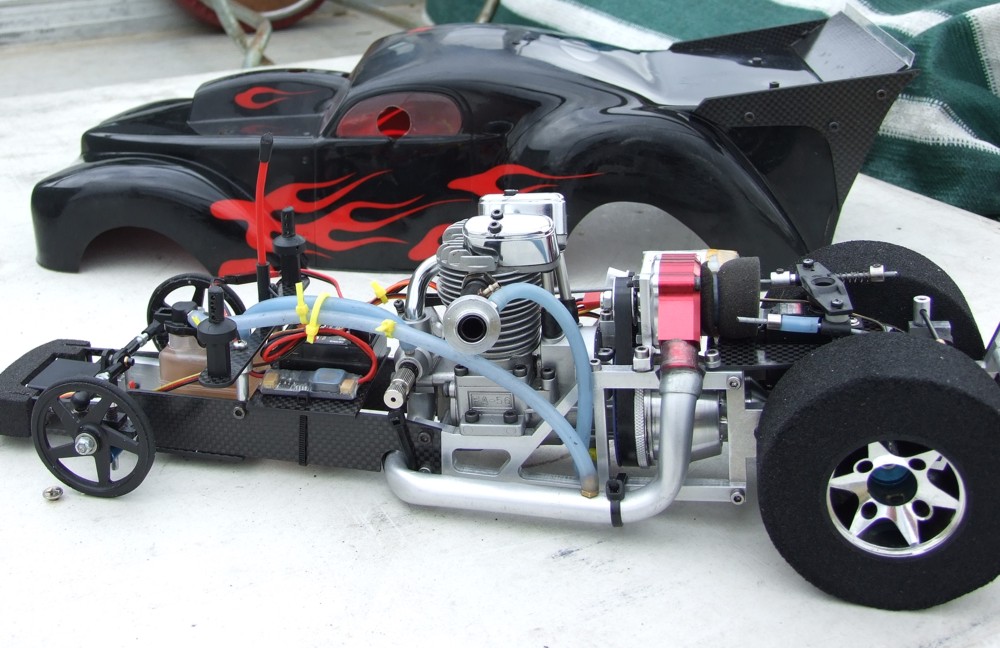

Aint this pretty!

4stroker in a drag car!!!... yours???

Naw, I think its iin Austrailia. Somebody posted it on my site awhile back.
Notice the blower?
