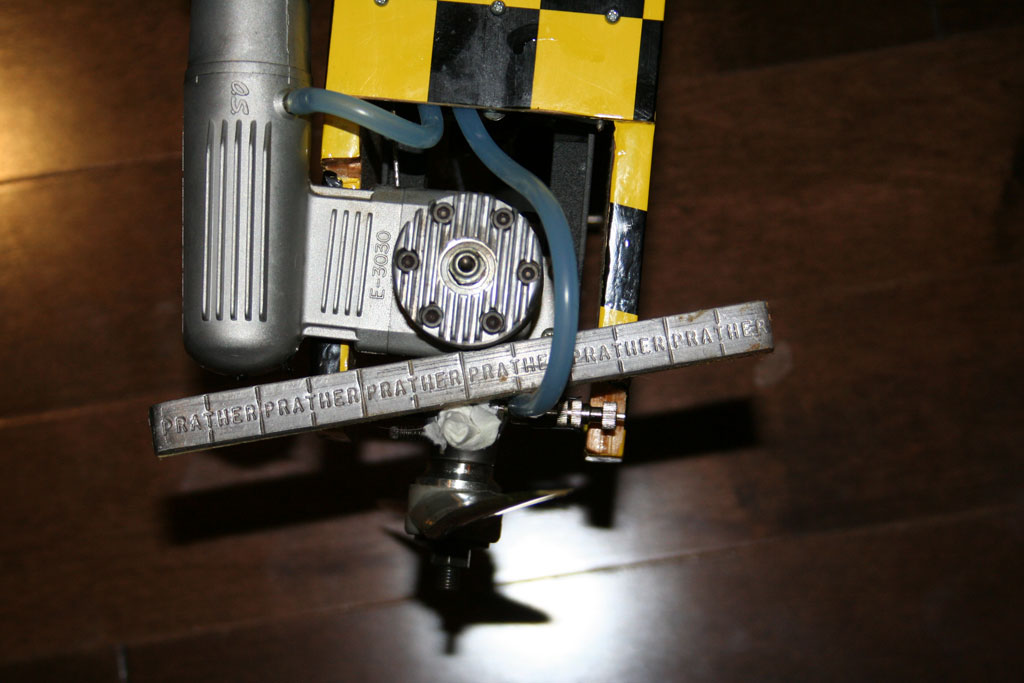

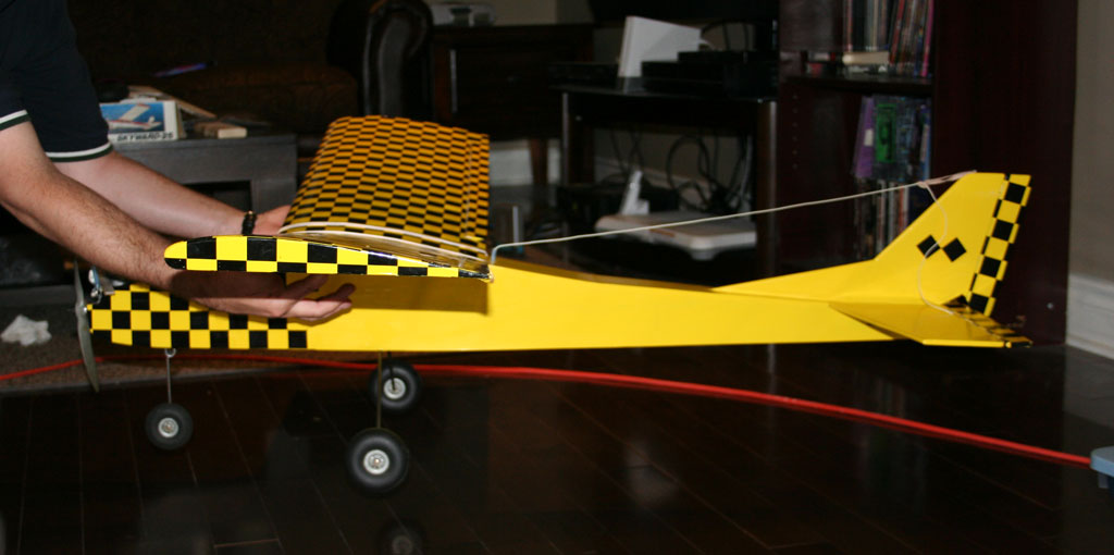

I have attached three pics. I think I'm tail heavy and was looking to get some opinions. A friend built this plane and I had to fix up some stuff. I took it to the field tonight and realized that I forgot to check the CoG. I picked it up and put my fingers about 12 inches each side of the fuselage and on the support beam that goes across the wing (I forget the proper name for it). Anyway, it seems to hang down at the back (tank empty).
I through a bar of lead weights on the front where the engine is (pic shown) and it seemed to level out a bit.
Can someone please give me their opinion?
i just helped someone at my field with that very plane, it balanced on the back edge of the main spar, . i didnt fly it but watching it fly i wouldnt go back much farther for training purposes. it needed some down elevator trim to make it fly strait and level.
that was with a magnum .40 gpa engine, similer to your os .40 fp (i think thats a 40 fp))
Yup, I think you're right, it looks a little tail-heavy to me. Before you add weight to the nose, see if you can get a better balance by moving the battery pack forward inside the plane. If that's not enough you might be able to add a 'heavy hub' to the propeller shaft. If you do add those weights, make sure and coat them with epoxy or CA after you stick them on, so that the fuel doesn't get to the adhesive and make them fall off in flight.
Jim you have surmised correctly that the airplane will only be in balance at the point you select if it sits level. The 'support beam' is the main spar. Most airplanes especially trainers will have the spar at the quarter chord (aka 25% mac, mean aerodynamic chord) and this is the ideal position to balance your airplane.
The lead is OK but as others have said sometimes other shifting of components is helpfull. Such as if you do not already have the battery all the way forward behind the firewall and under the fuel tank then I would suggest doing so rather than the lead.
Enjoy your maiden.

the 40 la and fp are some of the lightest 40s around....im sure when your kit was designed they did it around the heavier engines at the time. Mount the engine as far forward as possible, and mount the battery pack as far forward as you can, and use a heavy prop hub , i think Harry Higley makes them

so if you are farther back than that dont fly it. (i set up my planes where i read is a good spot on rcu, then add weight for the maiden and remove it as i feel comfortable)
if you really need that much weight, you could buy a ax46/magnum.46/gms.47/ect and you wouldnt need the weight

Thanks for the help guys... I do appreciate it.
The battery pack is already ALL the way to the front it can go. It is under the fuel tank and right behind the firewall. I even changed batteries which I assume is heavier now (2700mah vs. 500mah).
I was concerned with the weight of the plane after attaching the lead. I didn't know if my .40 OS was going to be enough to get it in the air after that. But, it seems the concensus is that I should add them, so I will.
Note: It was the main spar that I was on, I just couldn't think of the name of it.
Question: Attaching the lead - Should I remove the adhesive and attach it with CA? If I use Epoxy, I'd probably never be able to remove it if I get a new engine or something, right?

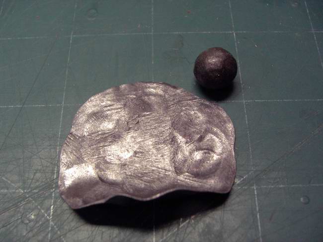

You can still get epoxy off with a knife. But whatever adhesive you use, coat the lead and the area near it with a light wash of epoxy to fuel proof it. If it's possible, put the lead someplace where it will stay without glue, then use the glue to hold it there.
For what its worth if one chooses to use lead there is an easy alternative source which is automobile tire weights and usually can be had for the asking. The advantage over the commercial stick ons is the chunks can be hammered on a vice or anvil in seconds to a paper thin consistancy then if you want to trim weight its easy to just use scissors.
In this condition the lead can be wrapped around stabilizer struts and a bit of thin CA bingo it disappears or moulded, shaped or applied just about anywhere such as a cheek cowl, here is a photo of a 50 cal musket ball shaped in this way.

Thanks for all your help guys... I have split that bar of lead in two and have mounted it under the engine on each side to keep it even.
I have glued it with Medium CA glue and have put a bead going around it too.
Should I also give it a light coating of epoxy?

You want to ad usefull weight? Install a Super Tigre 45 with the adjustable muffler. Plenty of power too! Also if you ad lead try mixing BB shot with epoxy and lay it in the nose out of the way of the engine and mount.

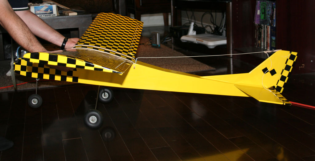

I go through all this because I have taken another picture and I was wondering what you guys think. Do you think the problem of the engine quitting could be caused because the fuel feed is looping too high (above the top of the cylinder head)?
And... I'm thinking I might need to change the prop? I have a 10x6 on it now but I have an 11x5 in my kit. That should give it more "pulling" power right? Should I change it?

ORIGINAL: JohnBuckner
Good heavens shorten that fuel line it should go right along side the cylinder. The fuel nipple should point almost straight back close to horizontal.
Joined: Apr 2006
Posts: 47
From: Brantford, ON, CANADA
That's what I thought. The nipplie is straight up right now, so I will turn it too.
The clunk is fine, I've taken the whole tank out to make sure that he had everything right in there.
Appreciate the help!
