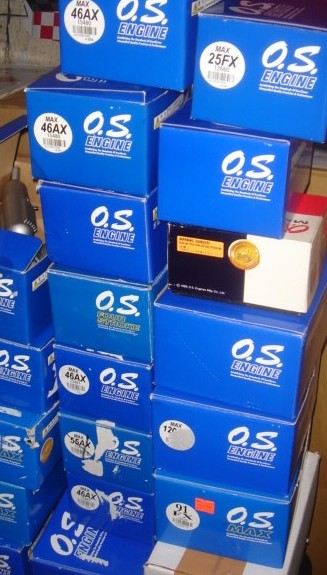

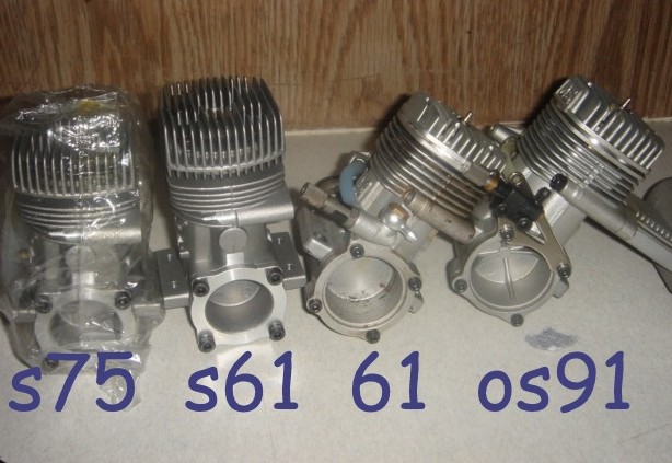

I can't agree more. I've had Super Tigre for over 30 years, and never wore one out. These like FAI fuel or 5% nitro content at the most. They also like larger props. Set up the engine with the right plug, fuel, prop, and you cannot find a transition issue, an idle issue, or a performance issue with them, certainly not at sea level at 90 degrees anyway. Some insist on just 12X6 props and 15% glow fuel because that's what their LA 65 ran good with on their hobbico trainer RTF.
Super Tigre performance is great for the money. I've never seen a China or Italian made Super Tigre differ in quality as some have commented. I regularly fly the ST .75, fits right in the .61 mount, so does the .90. Price an AX 75 lately? Forget it.
I enjoy using every engine I can find and rarely have issues. Oh, Fox baffles me how they continue to stay in business without a doubt. Never could get their carbs to work. The old days, you just tossed it and threw on a Perry replacement. I do use OS carbs on the G20, ASP, Magnums, when quality goes below average, you know, Monday A.M. and Friday P.M. production never is ideal.
