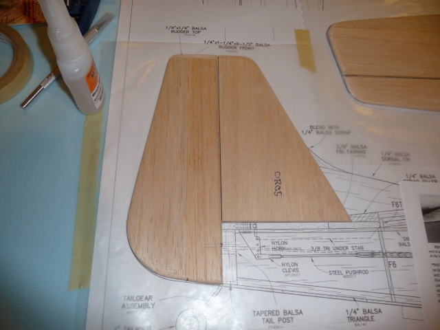

So far Ive got the tail feathers set up, glued and sanded. I used a hollow door and some DOW foam as the building surface. I have thin and med CA and 6 and 30 minute epoxy. If there looks to be somethign wrong, fire away!

I finished joining the elevators today after drilling the holes for the elevator wire joiner. Things seem to line up perfect with the plans and I used 30 min epoxy on them. Bruce, your right, I bought the 6 min epoxy but I cant really see using it when the 30 minute gives you more time. Im currently using CA but I will look into the wood glue. IM still waiting on hinges to come in so I will be moving onto the wing. My work area was a little frustrating tonight. I know it needs to be perfectly flat but when I gave the dow a good look there were spots where it diped down maybe .5mm. I wound up turning around the whole table to find an area that was perfectly flat for the wing. Am I being too picky or is .5mm going to make a different on the wing surface?

,5mm is tolerable

Let's see, 0.5 mm = 0.01968503937 inch. Hmmmm, there are those that would consider that to be dead flat as far as modeling is concerned. You have a great building surface if you have that or better. Well done!

Dufault.. on the elevator joined by the wire... I always put a piece of fiberglass around that joint on each half. You don't have to but that area takes a lot of stress and it's just somehting i do. Over time that balsa will weaken.
I hope the pic makes sense. Basically a C over each half. I run it to where the wire stops in each elevator. My 4* 40 had the same setup with the wire joiner and never had a failure.

That makes sense. Do most hobby shops carry fiberglass strips? I know some came with the kit but I dont think it came with extra. Another thing about fiberglass. When I was reading the instructions on puting on the fiberglass Im a little confused about how much CA glue to use. It says to put CA drops in a line until the whole thing is covered. Is that thick or thin CA and do I smear it in after?

It's thin CA and it should cover all the glass. Most people use 30 min. epoxy and spread it out with an old credit card, playing card or paint brush, It smells a lot better and doesn't cost as much as CA. I brush a thin coat on the wood first and stick the glass down then brush or spread on more epoxy over the top. Sort of feather the epoxy along the edge of the glass. Clean up using acetone or alcohol along the edges. Most hobby shops sell the glass by the Sq. Yd. and in different weights. There should be some glass left over from that strip they gave you for the wing center section. You can also buy glassing kits at the big hardware stores that has the resin/hardner and glass all in one, that works very well too.

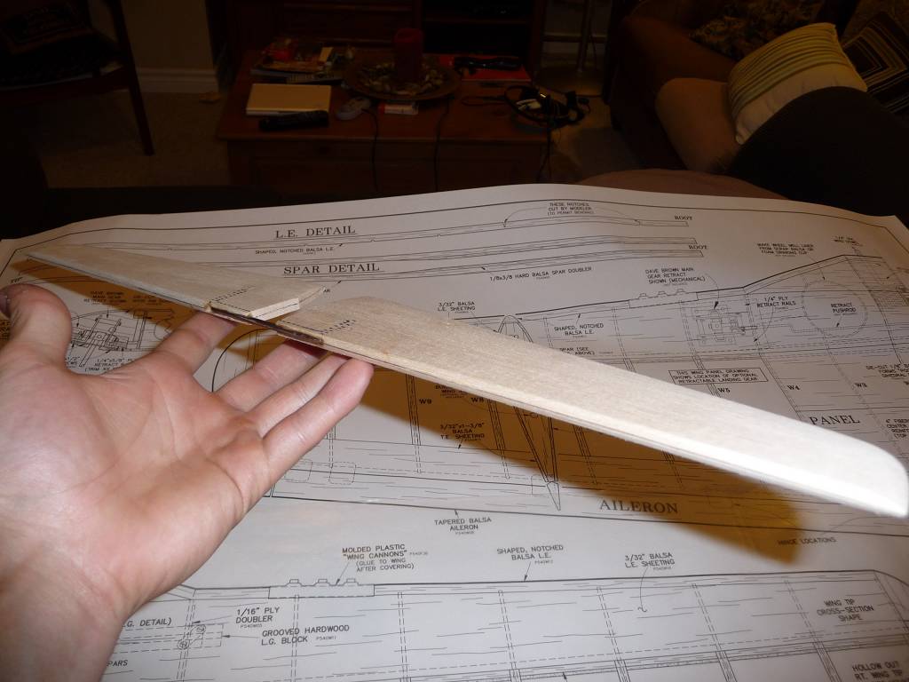

Well I got a little bit done tonight. Glued the spars together tonight and tried to counter the two parts so that I could straighten them slightly. Three out of the four look really good but the one curles up a little. I dont think its that big of a deal because its only a slight bend. What do you guys think? If I hold the one end, the other end points up maybe 1/4 of an inch. Its slightly better now with the other glued spart to it but not by much. I also cut out all my ribs and sanded. Im at a crossroads now where I actually have to make a decision about retracts. I really want to go for, so I might take a trip to the hobby shop and see if they have what I need. Hopefully its pretty standard. Finally, Ive been trying to decide if I want to get a pitts muffler and Ive decided its more less a must. I dont want an ugly muffler ruining my cowl.

If your spars are warped slightly, pin the spar so it matches my ridiculous little drawing. This will build the warp out of the wing. Do not assemble the spars so the bends the same way. This will build a warp into the wing.-BAD THING!

The spar drawing makes sense, but only 1 of them is sorta warped so so I place the warp in or out? Its pinned right now and I belive its getting better.

Pin it to the board just like the bottom spar in the 1st picture.
