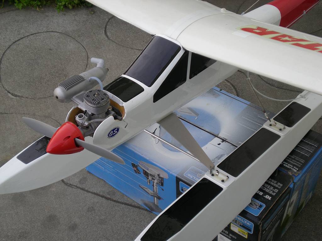

Dihedral will not effect how it "floats". Mechanically raise the ailerons a few turns on the servo linkage clevis connectors. Try 1/16" at a time. That will reduce some of the lift (by altering the angle of incedence). It will also fly faster with less tendency to climb at higher speed.
Old 08-24-2009 | 01:00 AM
My Feedback: (13)
Joined: May 2004
Posts: 4,177
From: san francisco, CA
Default RE: wing mods for a next star
ORIGINAL: Charlie P.
Dihedral will not effect how it ''floats''. Mechanically raise the ailerons a few turns on the servo linkage clevis connectors. Try 1/16'' at a time. That will reduce some of the lift (by altering the angle of incedence). It will also fly faster with less tendency to climb at higher speed.
yes the Nextar is a floaty plane but my plane is on floats LOL really, I also installed a OS 61fx, which I am swapping out for a OS 91Surpass 4stroke, the 61 is going into a FW190A ARF from Kyosho
