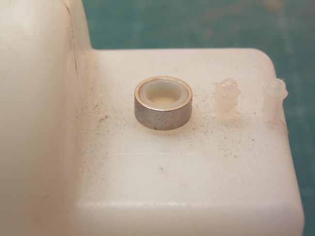

Check out Hayes tanks, can assemble them in about 60 seconds, I have used them almost exclusively for 20 years plus, no failures yet. No brass tubes, no bungs, no problems!

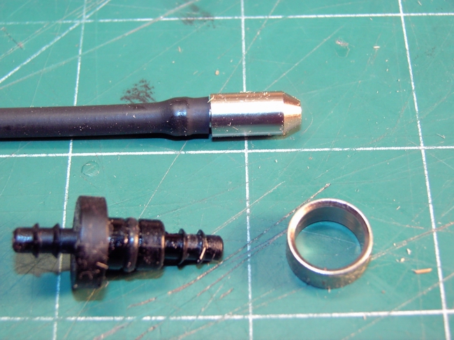

Old 08-26-2009 | 04:46 PM

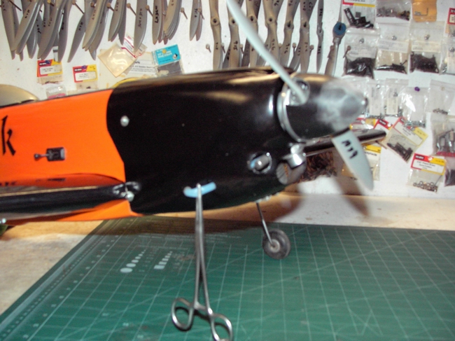

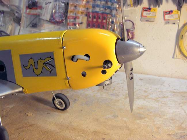

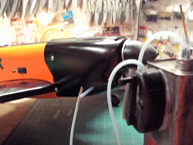

JohnBuckner's Avatar
Posts: 10,441
Received 11 Likes on 11 Posts
From: Kingman, AZ
Default RE: Finally fired up the enigine
Hayes tank are bar none the most reliable tank on the market today and as K3 vallley flyer stated can be assembled in less than a minute.
The o ring equiped plug can removed and inserted indefinately, try that with a conventional not gonna happen without leaks.
There is no need for a third line either, two line systems work just fine with fewer failure modes and thats with or without a cowl.
All new projects of mine get Hayes except for a small number that benefit from a Bubbless type tank.
In the case of some ARF projects I have done for my self as well as others I usually discard the included tanks and use only Hayes. A very high percentage of failures to get in a maiden on the first outing is often caused by problems of the conventiional tanks that would not have happened with a Hayes.
Many of these tanks I won,t even give away, I would not do that to people. There are also pacific rim ripoffs of hayes out there that can never function as they completely omitted the O ring in their direct copy.
John

Old 08-26-2009 | 08:39 PM
My Feedback: (-1)
Joined: Apr 2003
Posts: 14,400
Received 9 Likes on 8 Posts
From: Hemderson, NV
John, you better show some shots of a couple of your cowled planes so people can see how you fuel up and drain or your going to have a lot of new people scratching there heads. I'm still a three line guy but I am starting to give those really ugly Hayes a second though. We will see what happens after my next trip to the hobby shop.
Old 08-27-2009 | 04:44 AM
billd76's Avatar
Joined: Jan 2009
Posts: 1,183
From: Nottingham, PA
ORIGINAL: Gray Beard
JOhn,
thanks for the pics, I like the set up. I do like using three lines for the ones with cowls, but think you could drain one with the third line attached with plane inverted. or bt attaching a T in the main fuel line. Gotta get a hayes

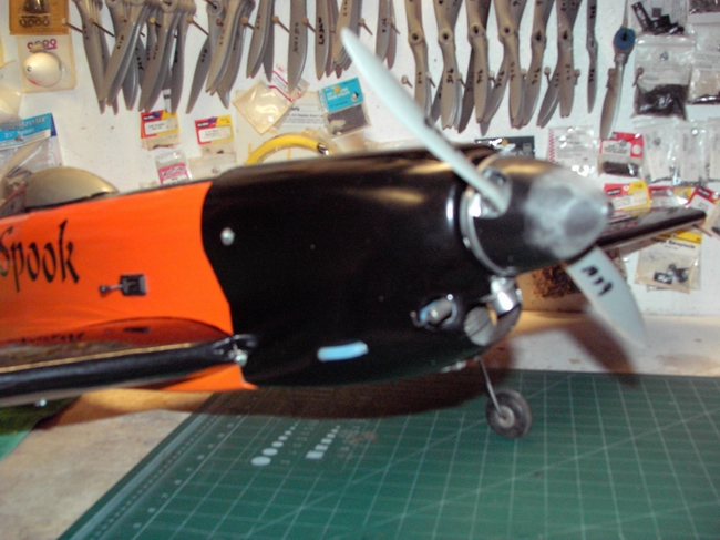

Old 08-28-2009 | 03:10 AM
Posts: 10,441
From: Kingman, AZ
Hayes have never been politically correct on RCU however they have always been the best and it is never neccessary to use a third line. This method provides the most important factor of all when using two stroke engines - a pinch line, try that with a third line ain't gonna happen.
I just cringe when some walks up and wants me to fly their beautiful cowled whiz band and expect me to break it in and tweek it in half a tank with only a hole to stick a long screw driver or something in to adjust the needle and no access for the midrange and worst of all no way in the world to pinch tune.
