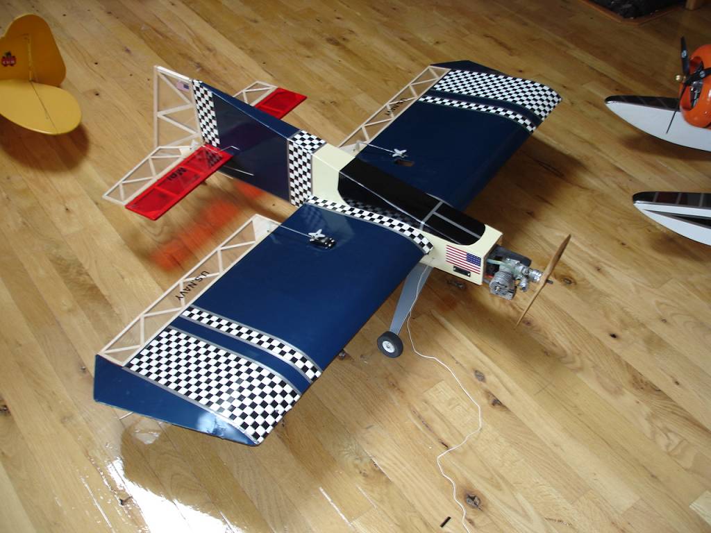

No not yet I don't. Just getting ready to slide the wing into the opening. Maybe the triangle stock may be my best bet. I can soak in amonia and H2O. Should be able to make the bend. The wing fits in the slot pretty good, not much of a gap.
Thanks Campy
It won't take much of a fillet as the gap is really quite small. Just want something to blend the fueslage to the wing. It is a scratch built Not-for-sale plane size 91 4 stoke. I fly the 40 size and it is a great flyer. This is a picture of the 40 size.
