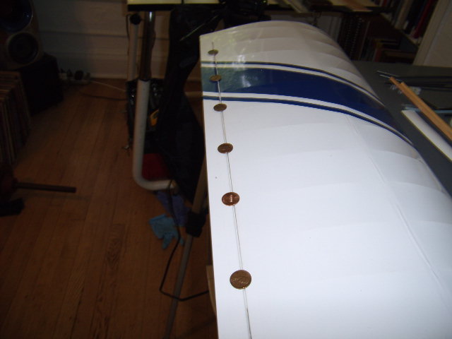

Hey Folks,,,
I'm building an Eagle 2 ARF, and there's a word that is used in the instruction manual, which I'm having a problem understanding its meaning ... <span style="color: #ff0000"><u>WICK</u></span>.
The manual instructions:
"Although the control surfaces of the Eagle ARF have been glued in at the factory, apply a drop of Instant (thin) CA glue at each hinge location, for added security. Allow the glue to <span style="color: #ff0000"><u>wick </u></span>into the hinge slot."
  1. Now before you answer this question, is it correct that the <u>control surfaces </u>refer to the <u>Ailerons</u>?
  2. And why apply glue to this area when it is already attachedby a small metalrod?
  3. what will happen if I don't apply glue to the control surfaces?
James<br type="_moz" />

Wick means to apply the CA to the hinge line and then allow capillary action to pull the CA throughout the hinge so that is gets firmly glued to the wood the hinges is in. Simply apply 4-6 drops of CA to each hinge and allow it to wick into the entire hinge. Also, turn over the wing and apply 4-6 more drops to the opposite side of the hinge as well.
To answer your three questions
Yes, "Control Surfaces" means the ailerons. It also means the rudder and the elevator as well. All of these are considered control surfaces</p>
  1. And why apply glue to this area when it is already attached by a small metal rod?
The "small metal rod" does not attach the aileron to the wing. This rod is called a torque rod and it's purpose is soley for movement of the aileron. It is what transfers the motion of the servo to the aileron. Hinges are what secure the ailerons to the wings.</p>
  1. what will happen if I don't apply glue to the control surfaces?
The control surfaces will more than likely come off in flight and the plane will crash.
Ken

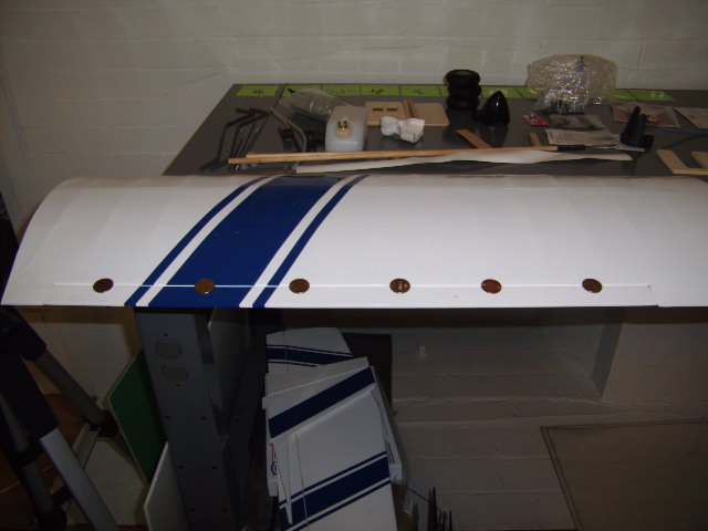

just to be sure I understand, the photos below indicate where the glue should be. Is that OK? And a word or two about: Hinges are what secure the ailerons to the wings. What's holding the aileron to the wing? It appears to be part of the covering but is this the hinge you speak of?

Yes, those are the locations of the hinges.
I should have done this in my first post, and I apologize. RCU member Minnflyer has created in excellent How-to on installing CA hinges. Read through it and it should answer all of your questions.
Installing CA Hinges
Ken

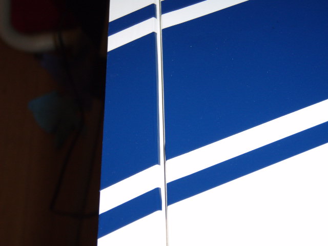

Wow, now I know what <span style="color: #ff0000">WICK </span>means. I applied the CA, and man did it <span style="color: #ff0000">wick</span>. So to understand fully what I did, by applying CA to this area I created a hinge with the glue. <u>The glue becomes the hinge</u>. So when I take the Eagle out to fly the ailerons will move up &amp; down as they should? I ask this question because before the glue, the control surface was flexible, now the airleron is static (fixed in one position). This is the goal, correct?

Scratch that last statement about the CA glue becoming the hinge(s).I mistakenly glued parts of the aileron/wing section along with the hinges. CA DEBONDERis on the way from Tower Hobbies.

You do have little 3/4" x 1" rectangular bits of hinge material in those slots, don't you? The hinges are the little fuzzy coated pieces of Mylar that the CA glue binds after thay are positioned into slots cut in the balsa edge strips.

I made the mistake of applying the glue without my eye-glasses, and put a few drops where I thought the hinge was.

That's another advantage of running a "T" pin through the midpoint before setting them in place. #1 you know they are equally set and #2 you can find them. Also helps to flex the control surface to the desired high-rate throw before applying the drops along the hinge-line. Then flex it the other direction and hit the opposite sides. This also assures you won't have binding from overly tight mating surfaces.
