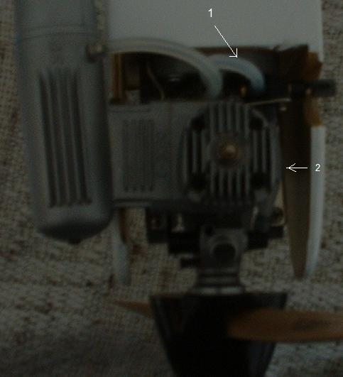

Hey guys,
I just flew my avistar again and there seems to be a big problem with the engine, i always fly for about 5 min and then the motor is going slower and the motor is going up and down (slow and fast) for 20 seconds and then it just quits, my tank is about 3/4 full and I had the problem on all my flghts today (Always made a nice dead stick landing)
Where could the problem be? I checked the tank yesterday and everythink semmend fine! Mabe the needle value?

It sure sounds to me like you have one of two problems. Either you have something obstructing the fuel intake ... clogged filter, or gunk in the carb, or there is some type of air leak in there. Double or triple check all of your connections, make sure your filters are all clean, make sure there are no pin holes in any lines.
I have an Irvine .40 that drove me crazy with this type of problem and I found that there was an air leak between the carb and the manifold. Some high temp RTV sealant around the carb and all problems cleared up.

Well if it there are leaks in the fuel system why does it run for 5 min without any problems? Also how can i make sure the engine is not too lean?

Try the obvious, and just open up the needle valve a few clicks and see if the problem goes away.
If that doesn't work, it could be an air leak inside the tank, in the clunk line. When the tank is full, the engire clunk line is in the fuel, but as the fuel level drops, the leak is now exposed to air and sucks in bubbles. Depending on the tank, this can eaisly happen where the clunk line attaches to the tubing that goes though the stopper.
Also check to make sure the clunk is not stuck against the front of the tank.
Make sure you don't have the fuel lines reversed. Usually you get shorter than 5min flights that way, but it's worth checking.
Easiest way to check is to see if you can pump the tank empty. If you can't empty the tank with your fuel pump, then you know you have a problem.
It could also be fuel foaming.
Next time it happens, take the plane back to the pits, and re-start the engine with out adding more fuel to the tank. Take a close look at the fuel line. Do you see air bubbles? Pick up the plane, and hold it nose up. Does the engine keep running with either a slight RPM increase or no change? If you notice the RPM drop off, or the engine quits, you are too lean on the needle or have some other fuel draw problem such as the ones above. Usually it's too lean on the needle valve.

Two easy tests to check an engine to see if it's too lean.
Both are best done with the tank 1/2 full of fuel, though they work ok with a full tank as well.
Both are done with the engine running at full throttle.
First, pinch the fuel line briefly with your fingers or a clamp. You should hear (or observe with a tach, but I do it by ear most times) a slight RPM increase. No increase means you are right on the edge, best back off a click or 3. An RPM decrease means you are too lean. Of course, if you hold the pinch long enough, the engine will drop off and die as you cut off the fuel. But you should still hear an RPM increase before it drops off.
Second, lift the airplane and hold it vertically nose up for several seconds. Again, you should hear a slight RPM increase. Any drop in RPM means you are too lean.

Put it in Line 1 so it's before the needle valve. This is what you must protect against getting any dirt in. The opening is so fine that the smallest speck can badly affect the mixture making it go lean. Lean is what kills an engine.

My guess is fuel foaming. While the Avistar is a great plane, the inherent design flaw is the fuel tank. It is mounted directly attached to the firewall and very prone to vibrations thus causing the foaming.
Make sure your prop is balanced as perfectly as you can get it since an unbalanced prop will cause the most vibration. If that does not work you my have to make some modifications. If you pull the tank out of the hole in the firewall you will have to seal that hole up somehow to keep fuel from leaking inside. Wrap the tank in foam and secure it.
