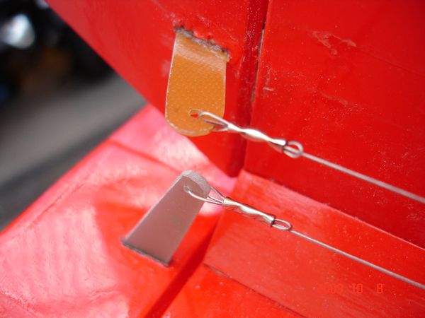

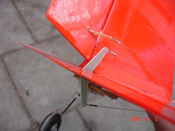

You can always change out your pushrods with CF tube and light 1/8 inch pushrod ends. Extremly strong and very light.
