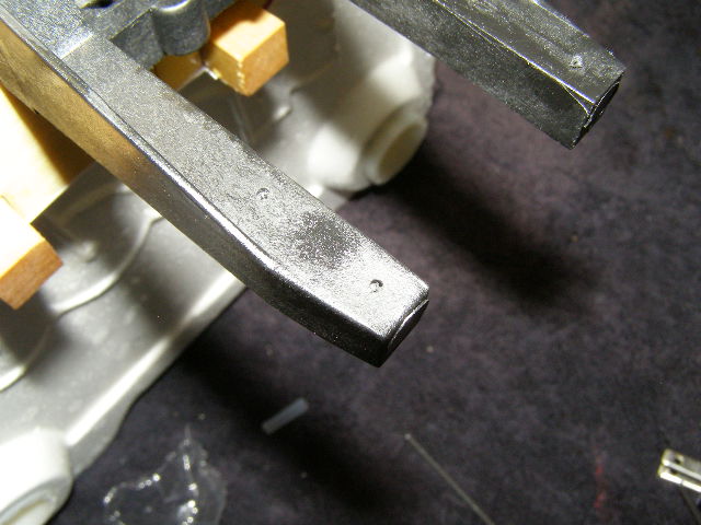

Here's a few of the pictures I mentioned. thought I had more complete steps photographed but I guess not. some is better than none though.
1- marking the location for the holes with the GP dead center tool.
2- Holes marked
3- Holes being tapped after drilling
4- Engine mounted

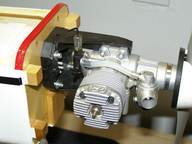

on all my mounts I tap the threads, and after mounting the engine using longer bolts, I nut the ends, it helps reduce vibration and helps keep the bolts from working there selves loose, having mostly cowled planes I don't have to check the bolts all the time.
the photo also shows the remote glow wire attached to the mounting bolt, I also have used the longer bolts to attach lead balast to the engine mount for balancing the model using a second nut to secure the weight as far forward as possable without securing exessive weight to a cowl.
