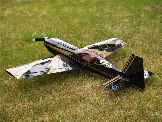

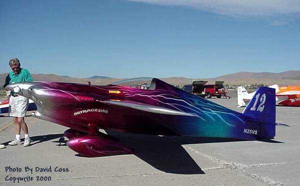

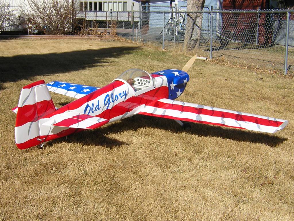

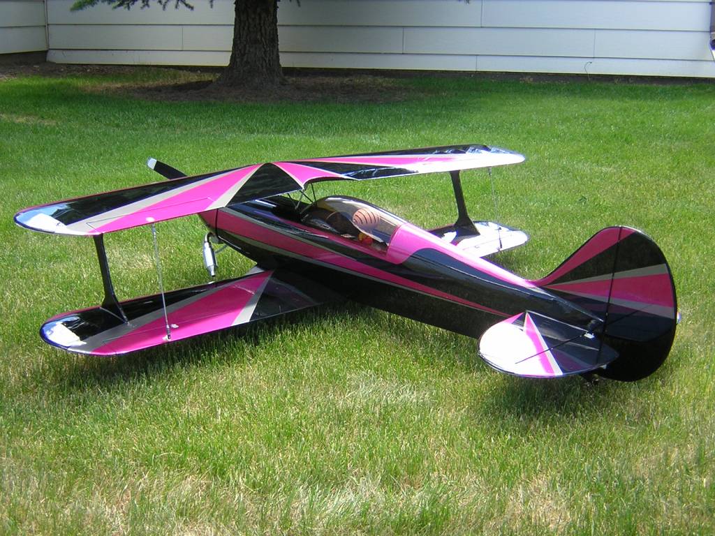

Ah, so how does one go about finding that 'perfect' covering job? Innate creativity is certainly helpful, but not required. The following planes all started out as 'blank canvas' after covering in the base color, ie:white, black. Trim was floated on with Windex. Monokote is ALL I use.
The Skybolt was one of my first 'complicated' designs, but the inspritation came from the box. I just used different colors is all. Old Glory and that SSE were inspired by the legendary 3D American Flag thread. The tail feathers on that SSE where inspired by a sticker that came with my GP Extra 60 kit. Speaking of the Extra, it was inspired by one of my wife's Egyptian lamps of all things, hence "Isis".
Google images is also your friend. Google image key word like 'cool paint schemes', or the like. Many of my designs start as inspiration on just a small part of somebody else's design. Pictures of full scale watercraft and motorcycles can also be used to give inspiration. Just be patient. Most of the covering schemes in these pictures have 60+ hours into them. And yes, I mean JUST THE COVERING!

Thanks Deadeye. That Skybolt is gorgeous!!! You guys are giving me hope.

Deadeye.... All I can say is wow! That "Isis" plane is absolutely gorgous. Inspiring indeed... Might be time to break out one of my kits or strip an ARF an do something similar

Gee guys, thanks for the compliments! Covering is my favorite part of building for me. I've got a TNP Shoestring that I will be covering by mid November (I hope!). I am gaining inspiration for the covering job, using the pictures down there. Those colors look sharp, and I know I won't get any blending effect from Monokote. But it's an inspiration, all the same.

Wow thats amazing. Being able to blend would be really nice!!!

You can... Fiber glass the surface, sand smooth, prime, sand smooth again, air brush.

I'm considering this...but also just the color combinations really struck me. I ordered pearl teal, metallic burgundy, pearl white, metallic teal, maroon, and platinum (platinum is ALWAYS used on my planes - it's the best complimentary color out of the whole Monokote lineup). I've got those rolls within sight of my project...that kind of gets the creative juices flowing as well.
Chances are it won't look anything like those pictures, but I bet I use a few of the colors.

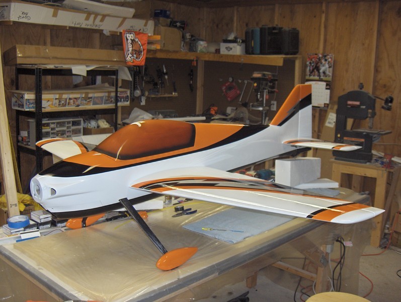

Here's my Northstar. It's the last kit I've built. I crashed it on maiden, rebuilt it, and am scared as &^%$ to fly it again. Inspiration was from a watercraft I saw on google images and saved it for reference....crash was no delta experience. Pilot error. I can be a really dummy sometimes. That's all hand cut Monokote. A couple of brewskis helps with steadiness cutting Monokote.

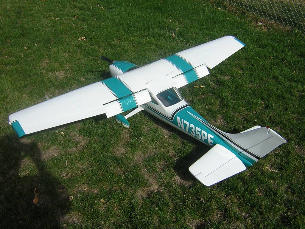

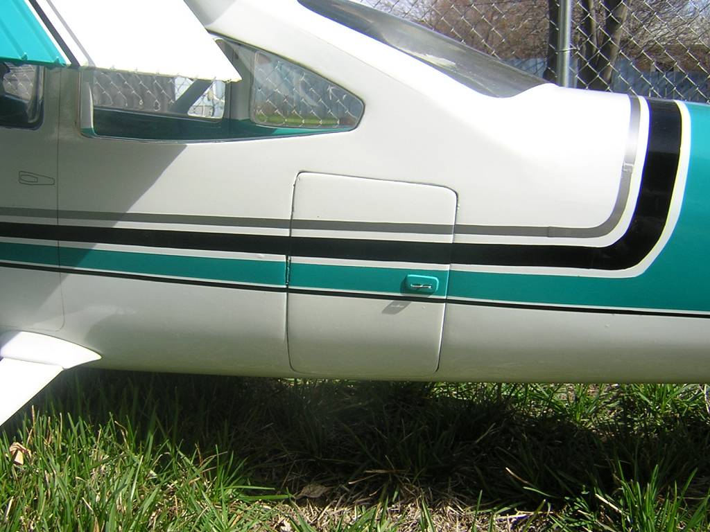

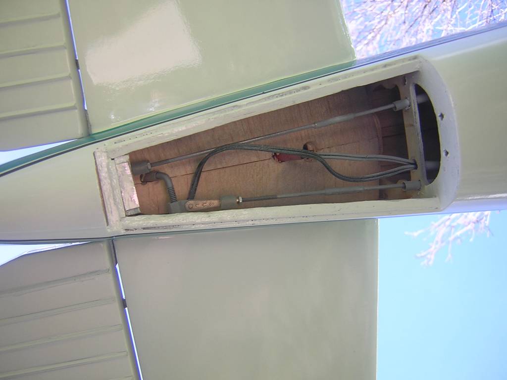

My Top Flite Cessna 182 took over 300 hours to build. At least 100 hours was just into the outer finish. It's all fiberglassed, and painted. I also spent a fair amount of time on my scale luggage door that hid all of my switches, fuel valve, switch control PCB's, and all that stuff. Scale Robart Oleo strut on the nose, Magnum 91 under the cowl (PERFECT MATCH!). It's got scale lights, including landing lights, and all the nav lights. It even features a lower cabin light for the barf bag compartment. Magazines are in the seat backs.
It weighs 14 and a halfish pounds, RTF, but it doesn't fly that heavy at all, and can be a real B&%#h to land sometimes with a wierd wind. It was my 3rd kit, and my first attempt at a 'scale' kit. I've only got about 30-40 flights on it, but it is very forgiving, no bad habits at all. She's my hangar queen, even though its not nearly as flashy as some of my others. But I sure as heck remember those hundred hours of priming, sanding, rinse and repeat for what seemed like a thousand times.
She's been worth it, though. Top Flite Kits always kick butt.

Very nice! You are talented for sure.

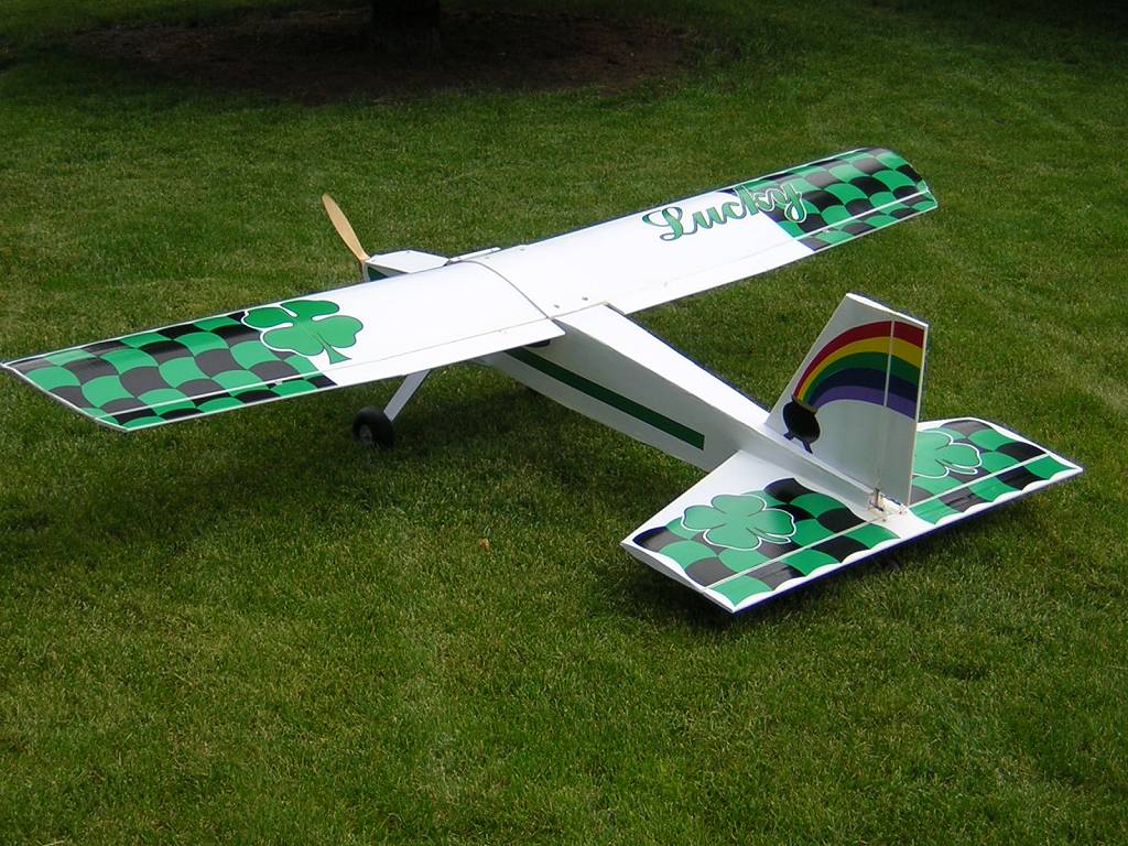

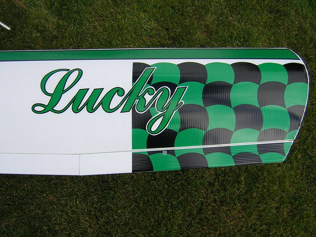

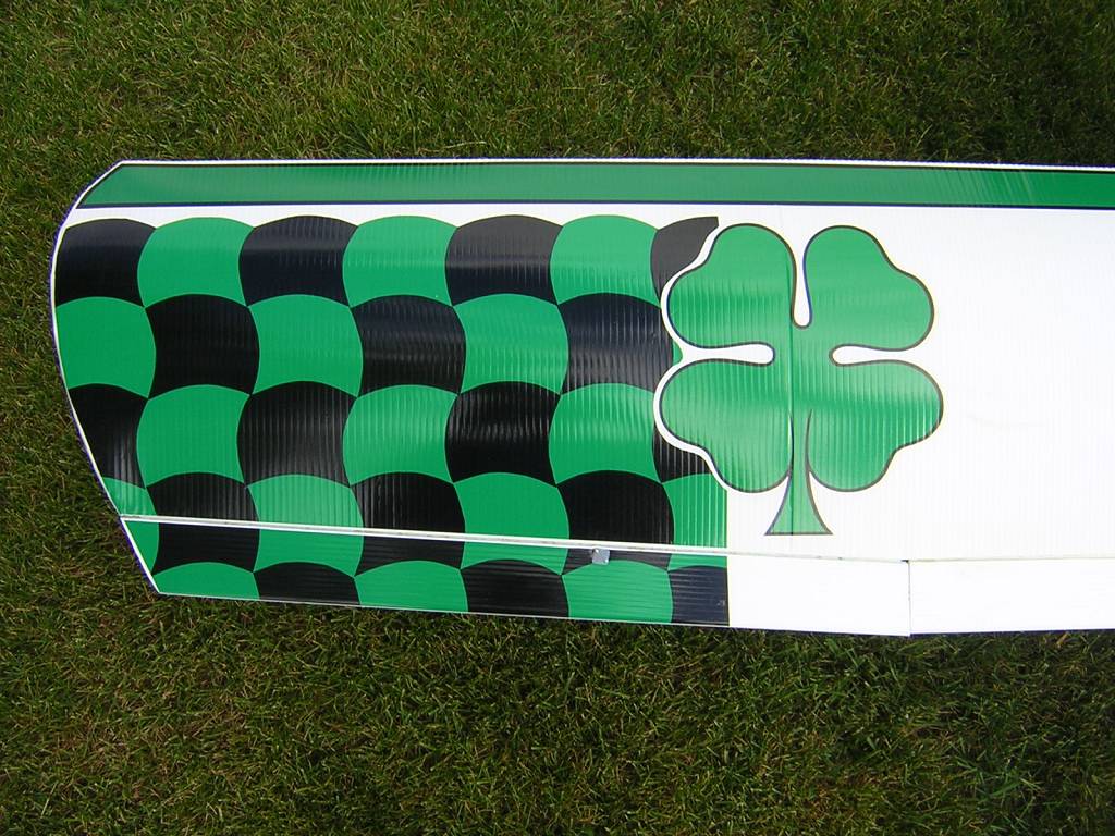

Thanks man! Next up is Lucky. Lucky was built my second year. She is a scratch built coroplast behemoth with an 8 foot wingspan and a Quadra 35 on the nose. She weighs in at 25 pounds, but she doesn't feel that heavy in the air. I have a bomb bay doors in the belly, and it can hold a coffee can of cargo.
The trim is all vinyl, and I cheated and had the 'Lucky" and shamrocks cut by machine. The checkerboard, however, is all hand cut.
