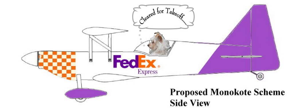

I think I've had just as much fun building the table as I have building the airplane! I also photoshoped my monokote scheme with my "Arkansas Trailer Trash Dog" as my pilot. See attached pix.
