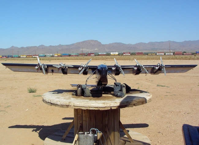

2. I use small sand bags, wheel chocks, or even a bungee hooked to a stake.

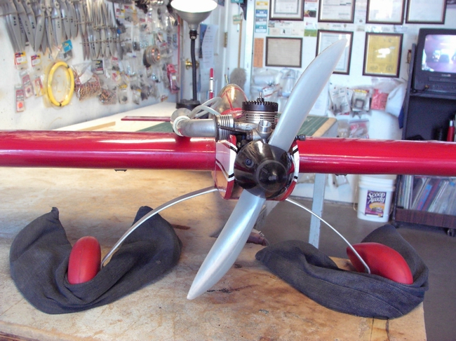

2. I also use sandbags both for restraint and in the wind. I make them out of denim material sown tubes about three inchs wide and about 24 inchs long and filled with playbox sand from home depot. They should only be half filled (this is important) that allows them to be shaped and placed anywhere.

Hmmmm sandbags for holding planes down...long ones work well.
NOW, I finally have a use for all of the SINGLE; ALONE; AND FORLORN.. socks in my drawer. Good thing I save all of that stuff. I guess I better put the sand in a baggie before I put it into the sock, though. I wouldn't want to leave a trail of sand everywhere I went.
Thanks for the idea. regards, Rich
They are invaluble in transporting the airplanes in vehicles and building on the workbench as well just restraint on the starting table.
I always have four or five in my truck and if made of denim they will last several years of daily use. The biggest problem folks borrowing them all the time and the need to chase them down later.
The key to the versatility is only half filling them.
John
John
