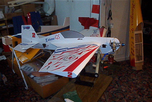

Old 11-03-2009 | 06:44 PM
Posts: 507
From: Rapid City, SD
Default RE: Painting Engine Compartment
I even seal with epoxy, and paint all my profile engine rails. Looks nice and keeps the fuel from saturating the rails
