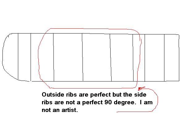

I have a quick question:
(Not that I can fix it now) BUT... I am building a Sig LT 40 and I just finished the first wing and the trailing edge where the ribs get installed was not lining up with the plans, so I lined it up with the most outside rib and then lined everything from there. Figuring that if that rib is out of alien then everything else might. (I have learned a lot from this build so far). But when I put the shear webbing in between the ribs, it pushed the ribs ever so slight out of 90 degree (probably 91 at the leading edge) side to side. they are 90 degree everywhere else (up and down).
So the ribs on the outs sides of the wing half I build so far are perfect in all directions but a few on the inside are not a perfect 90 with the leading edge. (I did not want to cut the shear webbing since it was "laser cut" and read somewhere that you should line up the ribs with that). That was my mistake and the second half will come out 100 percent better, and the rest of the planes I build.
My question is will this greatly distort how the plane flies if the ribs on the inside are not perfectly 90 degrees front to back?
thanks for any advise...
Patrick

If you built the leading and trailing edges on and to the plans it won't make a gnat's ***** of a difference. If, however, the chord of that wing (total width) is compressed because the ribs were angled it will make a tiny difference (less lift vs. the opposite side). Once trimmed in flight you'll never detect it because of the dihedral built in . . . unless it was a major difference.
The LT-40 is a very forgiving and self-correcting design. I helped an Explorer post build four of them and you never saw four differently constructed versions of the same kit with no intentional bashing. There must have weighed a full pound different between the four (one group used two bottles of Titebond and another only half of one bottle!). But they all flew very well and it was really hard to pick the heavy one unless you flew it immediately after the lightest. Great choice for a trainer and first build.

I agree with Charlie. The LT-40 would probably still fly like a champ if it was put together upside down with toothpaste and band-aids. A fantastic airframe.

Keep building and fly it. Trim the shear webs if you have to. You generally have to fine tune their fit anyhow.

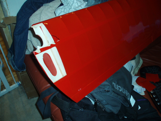

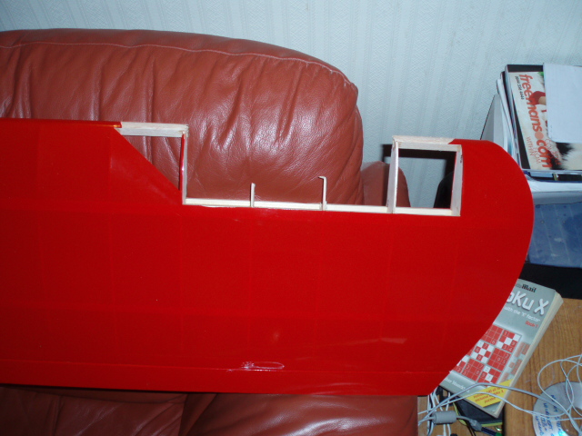

No I just have not put the dowels for the wings on yet in the picture. Thought aboutmaking perm wingsbut glad I did not as the rubber bands that hold a trainer wing on are there to give a bit of "give" in the event of hard landings and tumbles.
My plane was put into the safety fence on a dead stick second time out and I think the damage would have been far worse with a fixed wing. Think the fusalage or wing root area would have suffered.
Done a 24 hour repair and flew the next day.
Rebuild pics in "crash and build" section of forum.
First two pics lt40 damage, third pic is the somethin extra wings.
