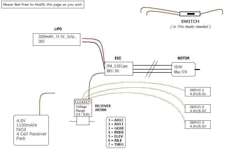

Hi , I am a total newbie when it comes to electric flight and in all honesty a little confused about what goes where and step down regulators etc...
Could someone kindly help me out with the diagram I have made of my set up and point me in the right direction.
My Questions are ;
Is it save to use the 11.1V lipo to power everything ?
Am I able to use the 4.8V as a back up battery , switchable durring flight ?
What is the manual switch for when you can power it up by the 2 deans connecter ?
Once I have this set up , I`ll be taking my 1st plane to the skys.
Many Thanks.

Your setup is fine. No switch is needed, when you plug the battery in, the system is powered up.
And the 4.8 battery is not needed. Everything will run off the Lipo pack

Remove the NiCd pack, and the switch from your drawing. The rest of the drawing gets a star, and will be less confusing. And as MinnFlyer stated, the Pack plug-in (Deans) will be your disconnect (switching effect).

Voltwatch won't do anything for the Lipo. It will stay green until the lipo drops below 6 volts, but if that were to happen you would already be in pretty serious trouble.
If you wanted to, you could use the nicad battery and the switch, and bypass the BEC. The only reason you would do this is for safety - if something goes wrong with the Lipo and you don't use the nicad, you lose control of the plane. If you use the Nicad and something goes wrong with the lipo, you lose engine power but not servo power, and can still land the plane.

What you need to do is remove the red wire from the connector that goes to the RX, from the ESC, this disables the 4.8V to power the RX. Then use the 4.8v pack to power the rx by using another available channel on the RX for power.
This saves all the lipo power for the motor. Most people use this set-up flying the larger electric planes.

The switch has 3 leads on it - one goes to the battery, one goes to the receiver, and one is a charge jack for charging the battery.
The hot (red) wire from the ESC to the Rx can be removed from the male plug. The three wires are clipped in, and you can lift one of the clips with a hobby knife and remove the wire. The ESC then only has the responsibility of controlling electricity to the motor (throttle).

Okay guys , here`s where I am with my electrics plus another newbie question .
I have removed the red wire so my lipo runs the motor and the NiMh runs my 3 servos which is monitored by a voltwatch2 .
My question now is , which battery will run out the quickest or do I have to do fly-bys and check the voltwatch to see ifl the NimH battery is still within its saftey zone.

Re charge the lipo after each flight !
Check the Rx battery before each flight
with a volt meter (loaded).
Bob

TheLliPo will be good for about 10 minutes of flight depending on power setting
The NiMH should be good for about an hour!
Just make sure the Voltwatch has the little switch set to the correct nominal voltage. I pack it in for the day when the unloaded (ie the servos aren't twiddling) reading is one LED into the amber. That's usually after 4 or 5 ten minute flights on a 2100mAH pack at 6V with 6 digital servos. So a 3 servo setup, 1100mAh 4.8V should have approximately the same duration.
