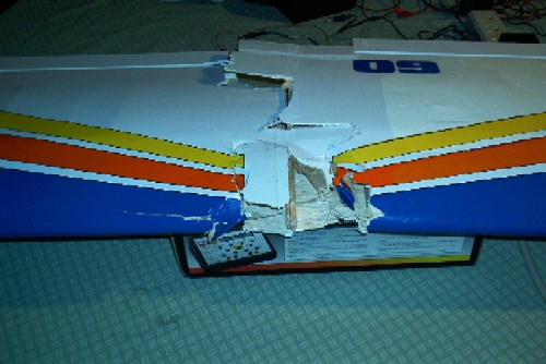

Here are a few pics of the damage on my trainer after I lost it and my instructor couldn't catch it in time to save it.
Most of the damage came from the rubber bands crushing the wing on impact. The fuse cracked and broke, but the repair was simple and straight forward. Repairing the wing is taking a bit of time and I will use wingbolts from here on out. I am also going to fiberglass the center section of the wing for added strength.
The interesting part of all this is I was testing the Flight Data recorder, from Eagle systems and I have a complete replay of the flight & crash. The damage sustained was from a 1 point spinner landing at 54 mph.
I learned three lessons:
1. Don't let your instructor think you know what you are doing, cause you don't.
2. Wing bolts are better than rubber bands.
3. The Flight Data Recorder is really a neat tool.
Do you like wing bolts over rubber bands?
Will get her back in the air soon.

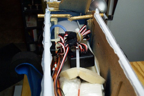

Here is the Flight Data Recorder, Battery & Receiver.
Here is also some info on the Flight Data Recorder.

Did you cross your rubber bands? If so, the damage can be exagerated considerably. I've seen wings separate cleanly with very little damage when the bands are laid fore-aft, but cross 'em, or cross the last two, and you might as well have epoxied the wing on. Lots of the old-timers at my field are horrified at the thought of no crossed bands. I think the reason they're worried about it is because the dowels supplied with most kits are on the short side, and they worry about the bands popping off in flight. I cut my own if I don't like the length. I think that bolts look better, but I'll go with bands for minimizing crash damage.

That looks like the Tower 60 trainer- same one I have. Cartwheeled it a few times and plowed it in in a landing and all I'll say is that I love rubber bands. The wing twists sideways and pops off and no damage.
I sometimes plow my sailplanes 2-4" into the earth (someday I'll learn to not make "one last turn" before landing). Rubber bands save them every time.
I use about 8 to 10 bands. I want enough tension where the wing won't change incidence under load, but not so much where I can't get some criss-cross movement when I push.
I bet at a 54mph spinner landing, it would crack-up anyway. The rubberbands just held the scraps together for you.
