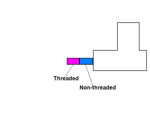

This is not likely to be the problem since you have a spinner backplate but it is a possibility.
Be sure the nut is actually tightening against the prop and not against the non-threaded portion of the crankshsaft.

You have one correct answer and one maybe up there. As usual good ol' "downunder' has it right. OTOH if you have a thin prop hub as some props are, relative to the unthreaded portion of the crankshaft, where the prop-nut stops short of a tightened-down position, then all comes loose when you try to start. BTDT many times until many years ago, an old-timer of that time showed me the error of my ways. Use the sandpaper between the spinner back-plate and the thrust washer. Doesn't have to be pretty, just there. Aluminum backplates really need it and plastic backplates usually need it.
