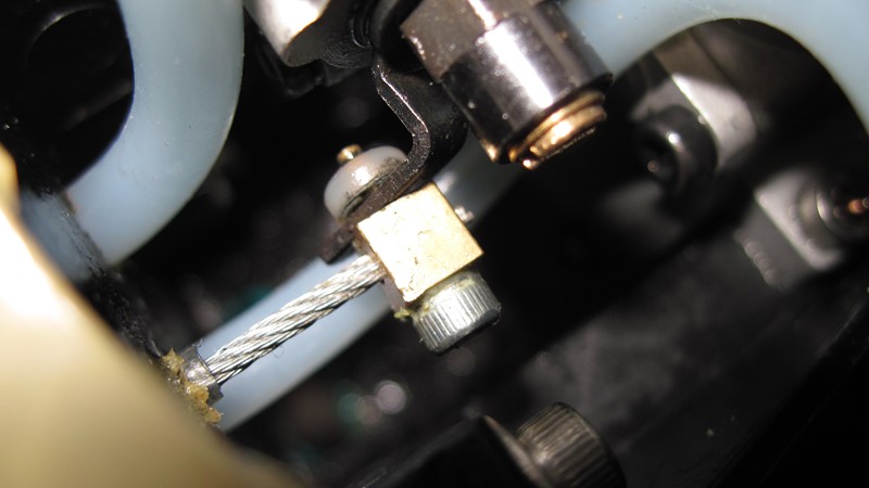

This often happens when metal is aloud to rub against metal, and I think this is the real cause for the problems rather than saturating the RX with a too strong signal.
My advise is to replace the throttle pushrod (or metalwire in this case) to a plastic one!

And yes, the throttle arm is metal and I'm using an EZ connector on the throttle arm, which is probably not helping huh?
Hummm. This is finally sinking into my old arse brain and making sense thanks to you guys. And now, I have no idea what to do besides pulling the tank, motor and trying to figure out a new way for throttle control.

Gary, when I said clevis, I was refering to the connector from the cable to the engine's throttle arm. Looking at your picture with a metal ez-link attached to the metal throttle arm, that could be the cause or a contributing factor. What you might do is solder a DuBro threaded solder stud to the cabel and use a nylon clevis to connect it to the throttle arm. This will eliminate metal on metal. I use an ez-link at the servo end of the cabel to allow the connection to be adjusted for length.
Bruce
Bruce
To me that picture shows the real problem.
You have metal rubbing against metal there and the metal wire also acts as an antenna for that. This type of problem will only show up when the engine is running. It caused by vibrations and will happen for any engine (gas, glow or diesel). A plastic clevis and preferably also a plastic pushrod should solve the problem.

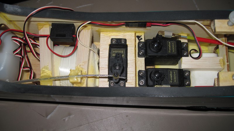

Garry, It looks like your receiver antenna is running right next to and parallel to your battery wires to the receiver for a few inches. That is a very bad layout. That will lead to a lot of coupling you don't want. Get them separated by as much as possible. Dan.
That was the first thing I thought of and that is something I can do quickly. Replacing the throttle set up wont be easy.

Well, I did some wire re-routing and will see tomarrow if that helped. If not Ill being into heavy surgery replacing the throttle linkage, RX and servo.
