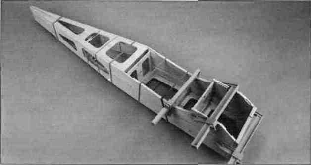

I like to put the VoltWatch near the Instrument panel.

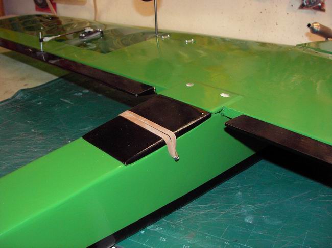

Jigeye,
Try not to cut the original fuse wood.
In that way, you will keep the original bending and twisting strength.
If possible, try using the openings of the bottom side of the fuse.
Happy New Year!

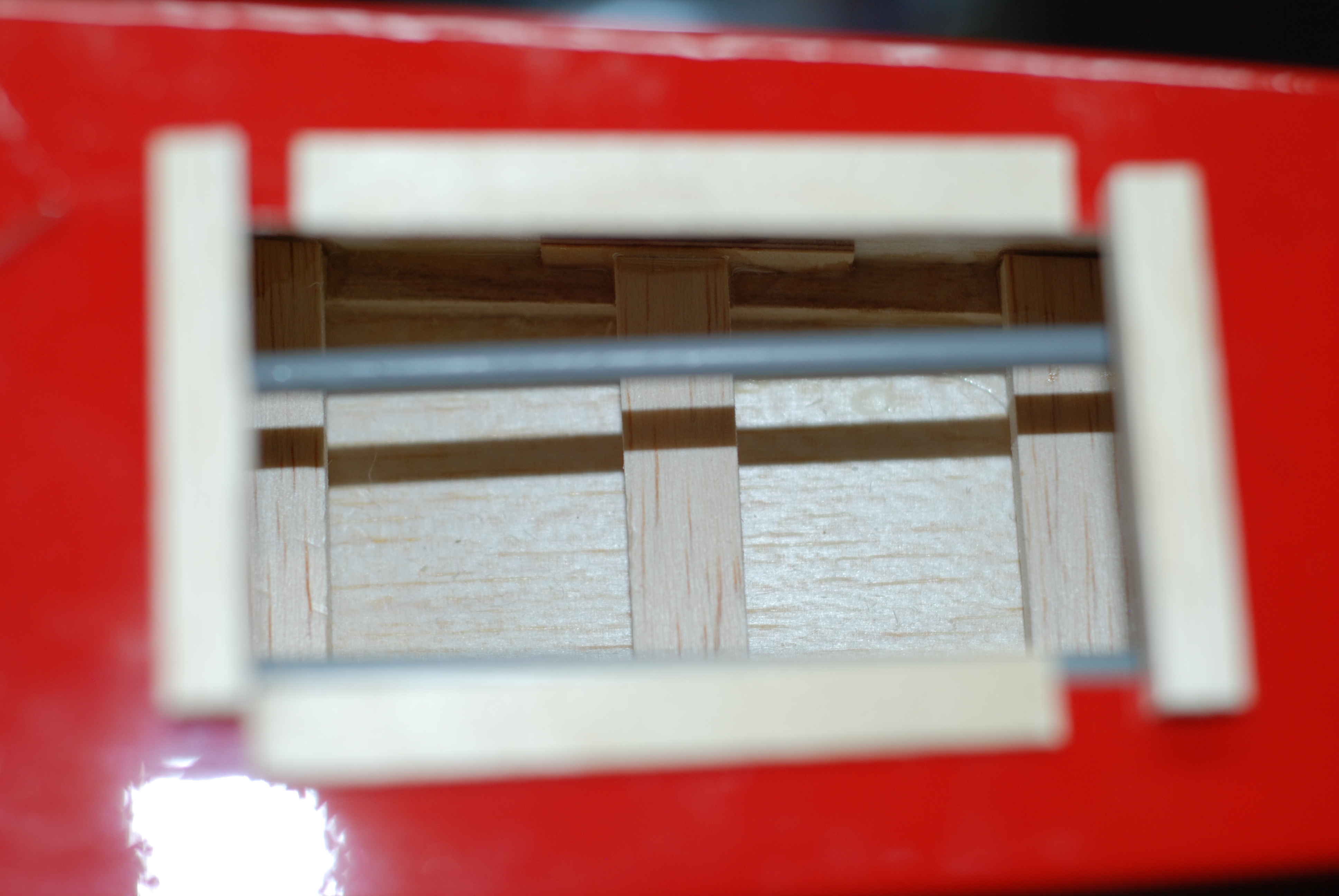

Here is what I did to my Tiger 60, You are just putting the hatch in a different place.

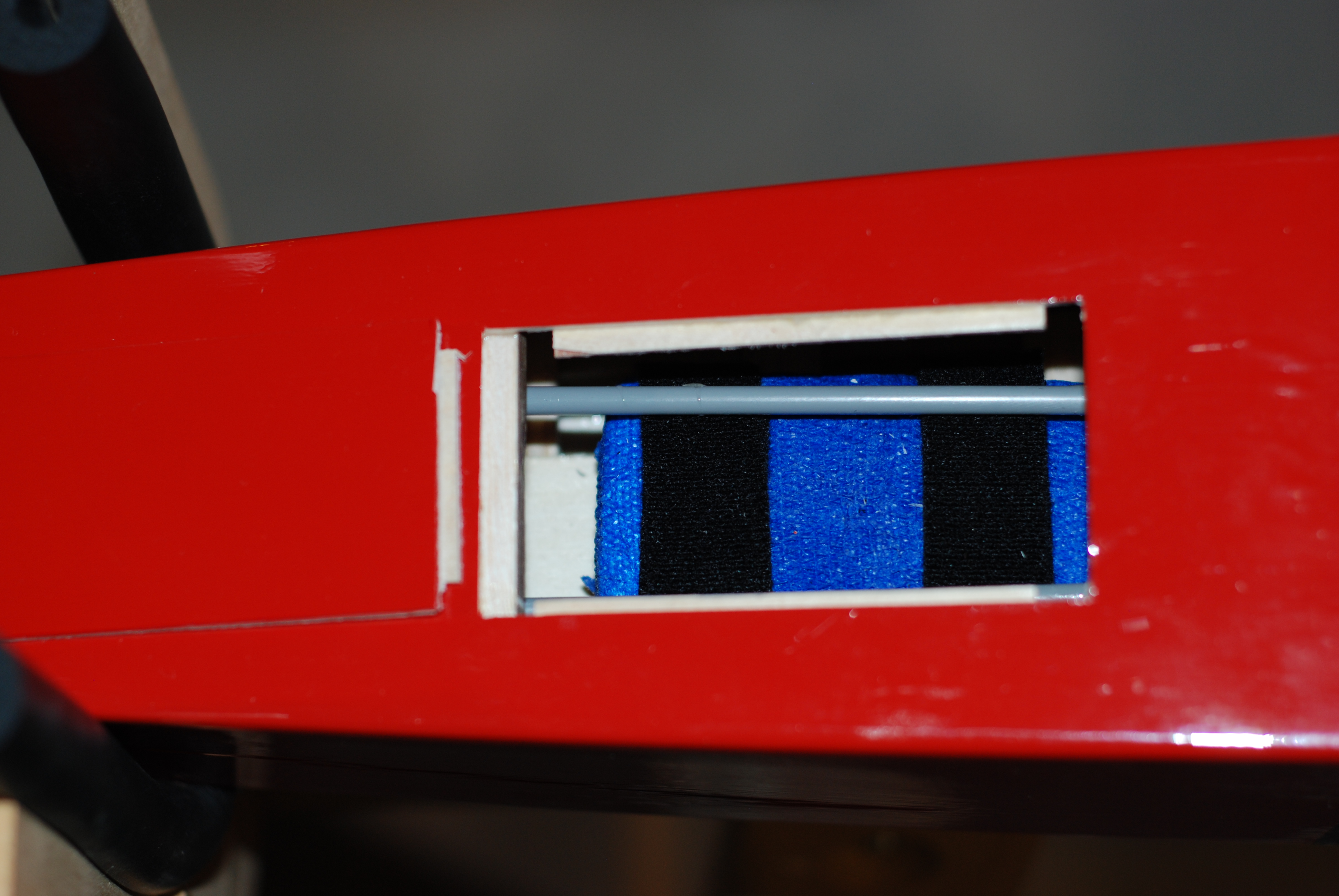

Default RE: Hatch Building basics

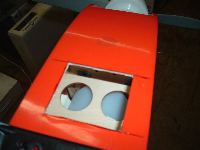

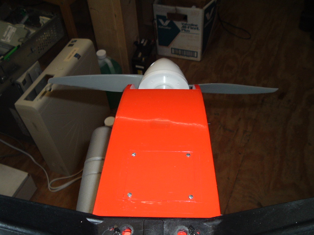

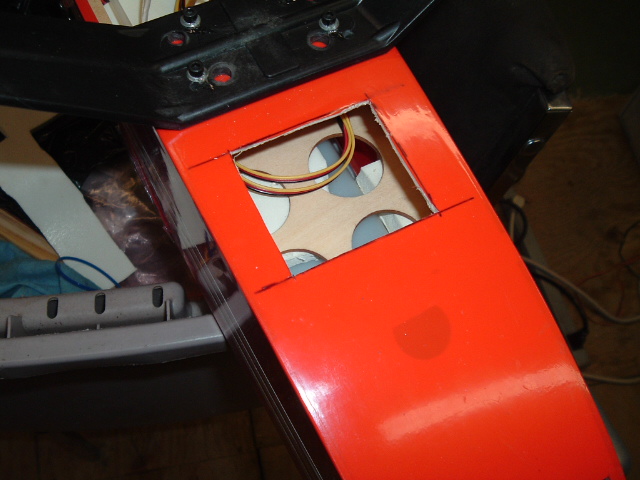

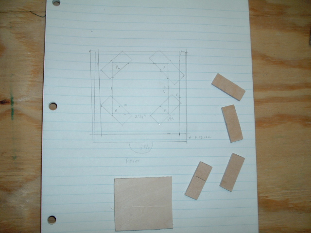

Sorry for the delay. I still haven't finished the work, but here are some pictures to give you an idea on how I am going about it. The first picture shows the reinforcement inside the fuse to handle the weight of a 2200mAh battery when the plane is thrown around (I put the "lips" on top of the fuse just to show them. Sorry if they seem out of focus, I had the wrong aperture lens on my camera when I took the pictures.) I then glued a thin rectangular piece of plywood about the size of the battery on top of the three cross bars so that I could wrap the battery with two pieces of velcro; this is shown in the second picture.
Hope this helps and little, and good luck with your project.
