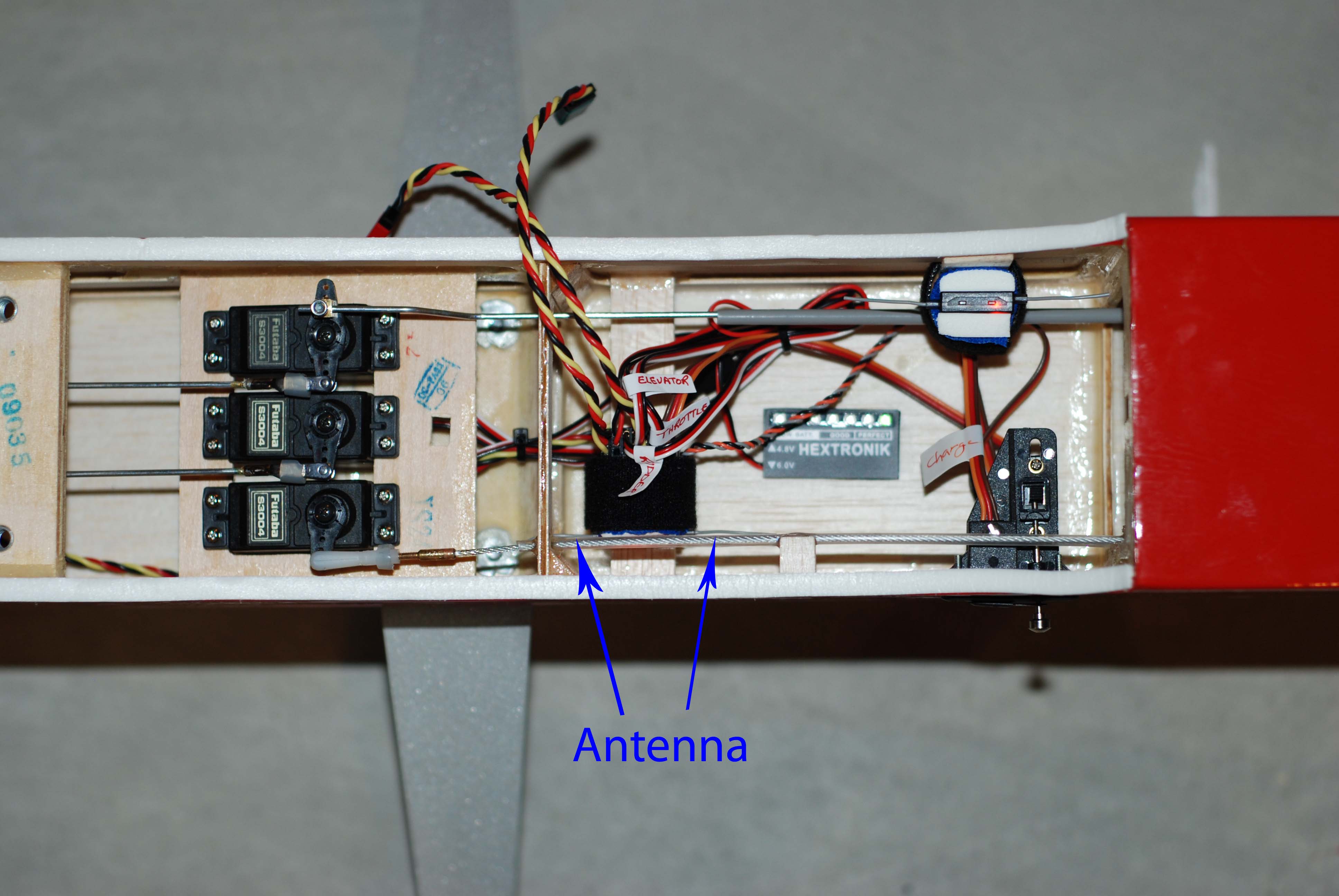

Those of you with more experience with Spektrum systems, can you please take a look at this receiver installation and let me know if it seems OK?

You have the main horizontal, and the satlite one should be vertical. Also what I would do is rotate the main reciver 90deg to the centre so the antena is at right angle to the throtal cable, shown by green line.

It's a clean secure installation which is excellent but the antennas on the satellite receiver are parallel to the ones on the main receiver as you have it. They need to be perpendicular. Just rotate one of them 90 degrees and it will be perfect.

You guys both told me exactly what I thought, as this is exactly what the instruction recommend. However, in the same instructions, there an installation picture showing the exact same set-up as mine (antenna parallel to one another.)
To be safe, I'll turn one of the them around 90*. Would it matter which one? It would be easier to turn the satellite receiver.

No it would not matter but it is easer to rotate the satlite.

Remove the Hextronic voltage monitor from the top of the fuselage and mount the satellite receiver there, with the antenna elements 90° to the main receiver. Push the satellite receiver as far forward, as far away from the main reciever, as possible.

Why would this be better than just rotating the satellite 90*?

I couldn't tell from the picture if there was enough room on the side of the fuselage to turn the satellite 90° and still keep both antenna elements straight out. If you can do that then you will be ok doing it this way.

Yeah it's hard to see, but there is plenty of room. Thanks for the clarification.

The reason they are mounted perpendicular is to provide diversity in the way your radio sees the incoming radio signal. Because 2.4 Ghz radios have a very short wavelength they are more prone to being shielded or blocked than older radio technology. Items such as the engine, muffler, fuel tank, carbon fiber, or other similar things can temporarily block out the signal to the receivers. If both are oriented in the same direction then when they are shielded is possible that both will not receive signal. By turning them perpendicular to each other you have a better chance of one still receiving signal when the other one is shielded. This is the same reason that the antenna elements in a FHSS radios (Futaba, Airtronics, Hitec, etc....) are placed at 90° to each other as well. It's done to provide your radio with better chances of keeping signal while flying.

Also, think of the RX antenna as a "net" to catch the signal from the TX. Oriented parallel to each other and running fore 'n aft as you have it, you won't get much of that "net" to catch the signal. Rotate one of the receivers so that the antenna runs vertical and now you'll get at least one receiver with the full span of the antenna exposed to the TX signal if it's headed away or toward you.
