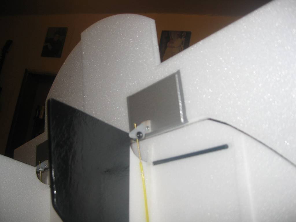

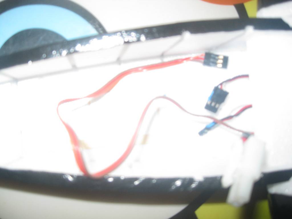

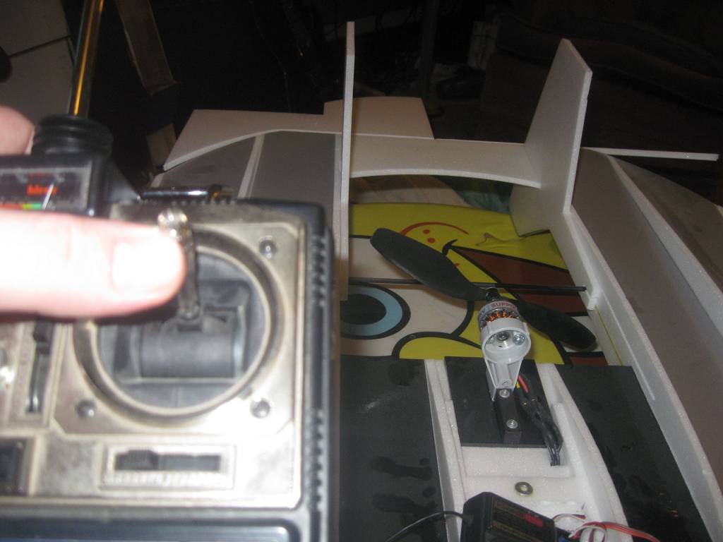

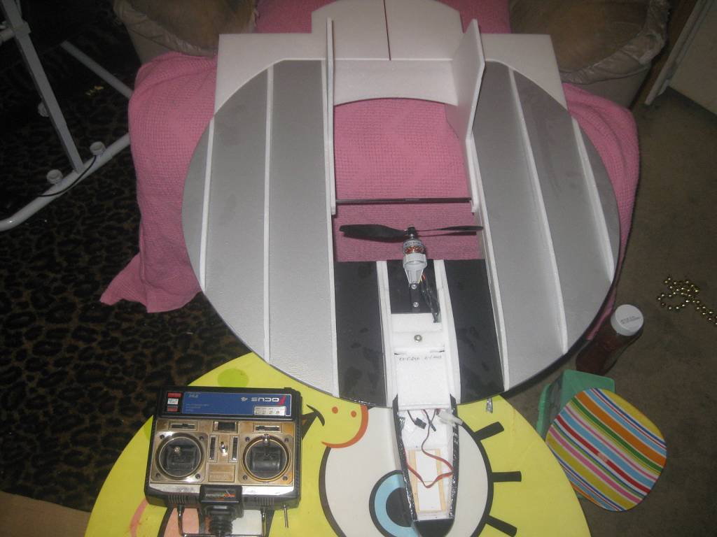

ok this is what i got, ufo i dont know if its homebuilt or a kit if anybody know please tell me, im trying to hook it up and it has this, 2 servos and brushless setup, can i use my hitec focus 4 setup with my hitec rcd3500 reciever or do i have to get diff radio and reciever, ive been messin with it and i can only get it to beep once then nothing or beep continously, i dont know much about this thing, thought it was interesting so i bought it, i dont know how it works so please help me

You can use your existing radio with no problems. But you need to find out the info on your ESC as that's where your problem is. Many ESC's out there have an "arming sequence" that you have to go through. Some will need for the throttle to be brought to the idle position, while others require idle to full throttle and back to idle, and other have different procedures to arm the ESC. What brand of ESC does it have??
Arming usually only affects the throttle, you should be able to control the other control surfaces even without the throttle not responding. Do you get any type of control out of it at all?? Can you take a picture of how you have your receiver, battery, ESC hooked up??

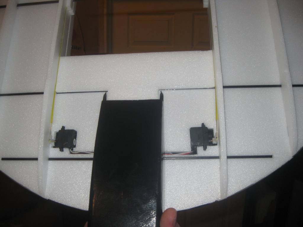

That plane requires mixing for elevons. And I don't know if that radio will do it. Sometimes the throttle needs to be reversed on some ESC TX combo's.BW

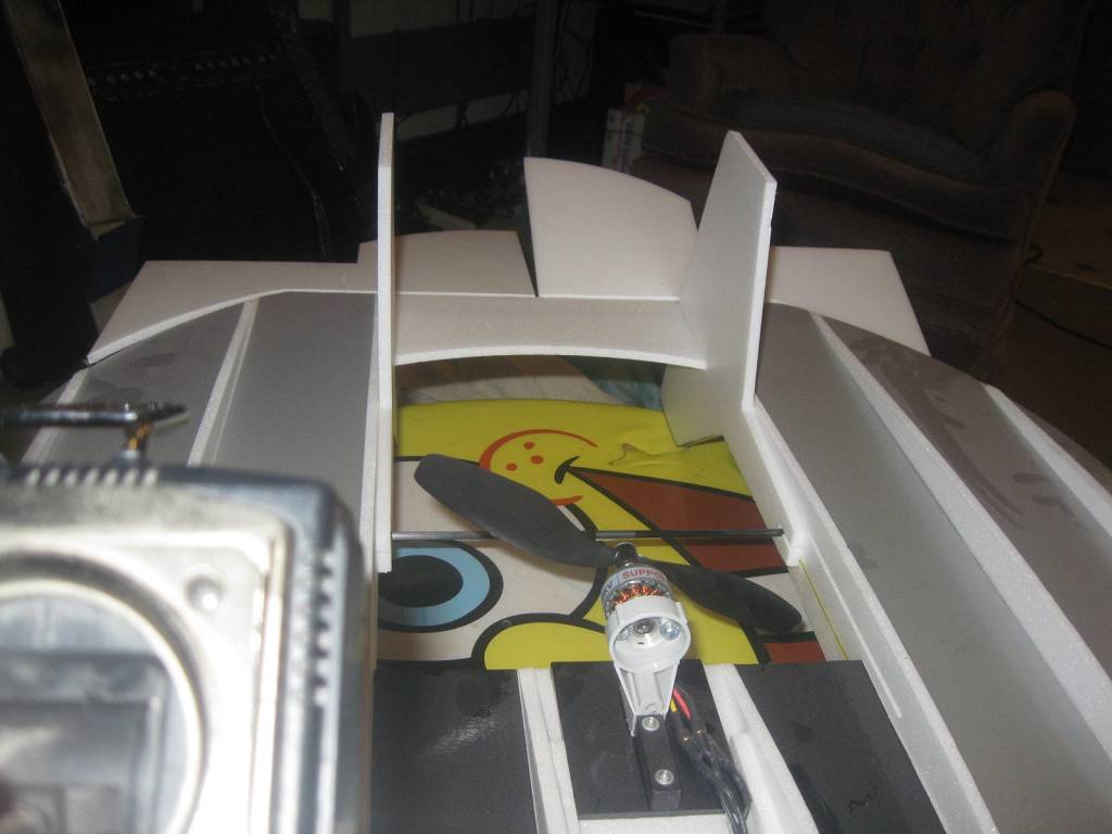

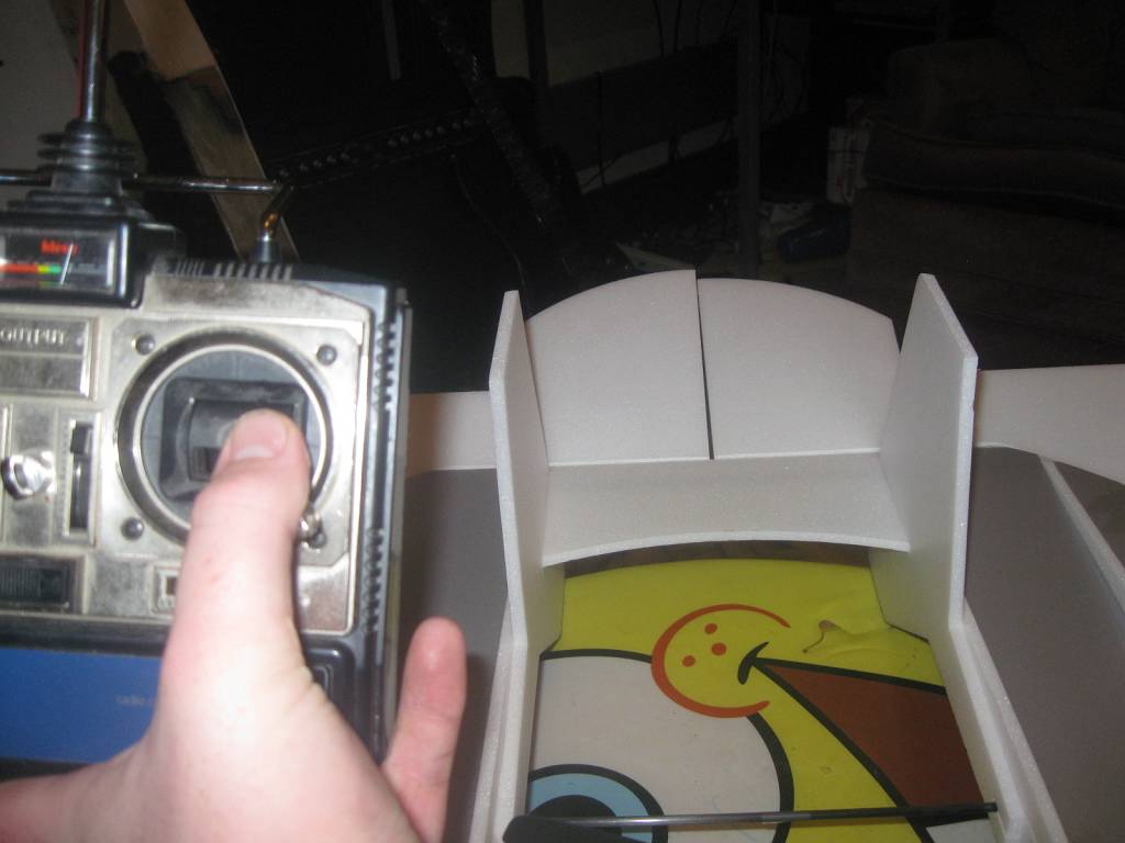

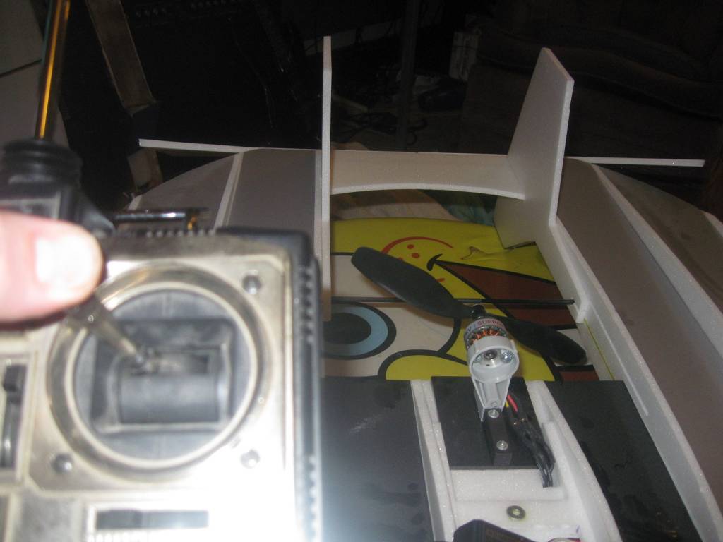

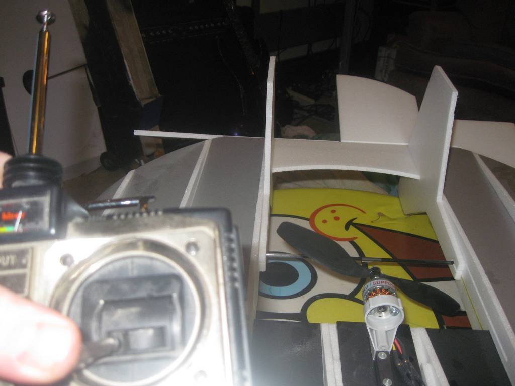

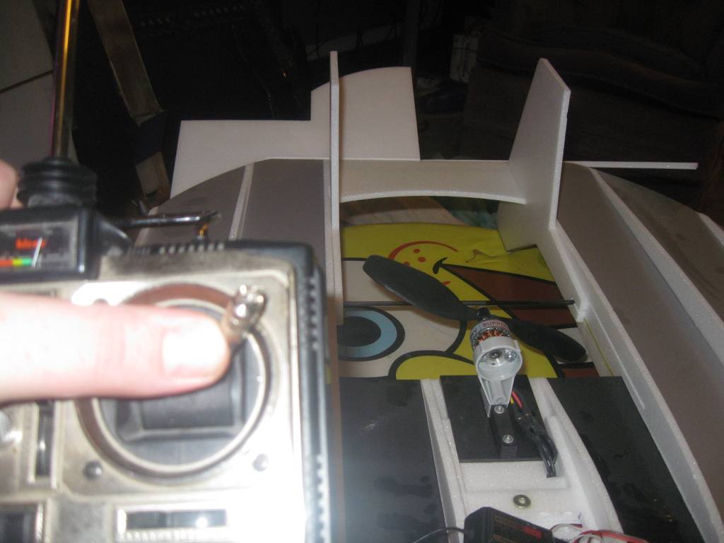

ok i got the motor to work its full throttle then back, ok this is weird i have to with the right stick of my radio....to go up you have the stick at bottom left, down you have the stick top right, and so on see pics and where my flaps are pointing i got right servoon channel 2 i go left servo on chan 1 i got throttle on 3, my reciever has 7 slots and a batt one, please help

You need to set your radio for an elevon mix. The controls on the back are both your elevators and your ailerons. Unless you have a computer radio you won't be able to set this up. You don't want a V-tail setup as those are a mix of rudders and elevators, which is different from an elevon setup.

Dopey -Yes I think so..If it was built into the radio you would have to use rudder(channel 4) and elevator(channel 2).If it was seperate (on the plane)You would use Channels 1 and2 for the mix and 3 for the throttle. I am not sure I do not own a Hitec but from what I see in there description this would work.- But you would have no ailerons and you would be rolling with the rudder.-BW
