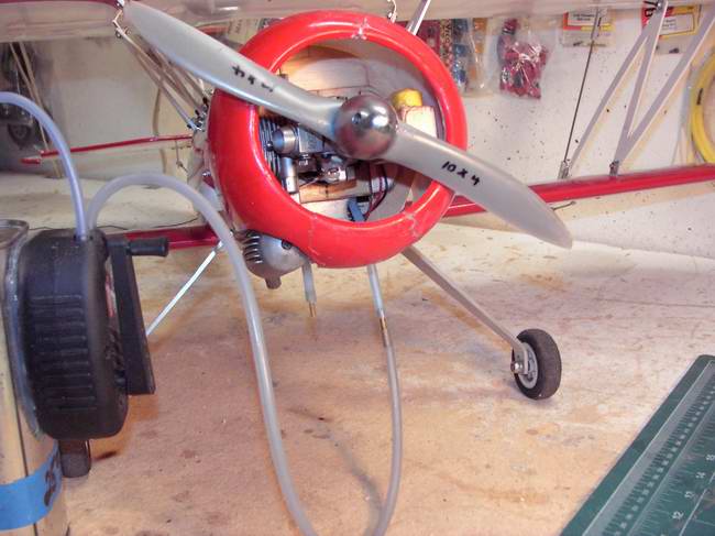

The most trouble free, Cheapest, easiest to use and reliable system possible: Two lines just like a trainer.
John

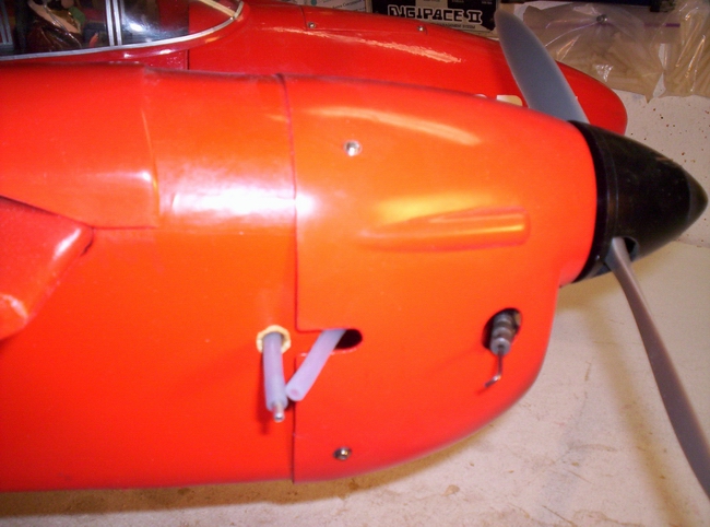

I just use a 2 line setup on my phoenix 300. I chopped a hole in the top of the cowl to have easy access for refueling without filling up the carb using a 3 line. All I do is remove the line from the fuel filter on top, fill the tank, and when it drips out of my pitts muffler I know its full. My overflow line stays connected to the muffler at all times. I build my planes to fly, not to look at!

The overflow line doesn't fall off the brass nipple on the muffler in flight. I don't use any barbs on this hookup. I refuel and defuel through the rear line of the fuel filter and when the engine is drawing fuel no sediment gets into the engine.
Opps, I thought you were talking about My setup.....sorry

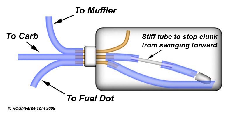

Add a third line (all you need is another piece of brass tubing - most tanks are set up to accomodate a third line like RCKen said) and plug the line with a fuel dot.
The third line can be usd for both filling and de-fueling

I've used Minn's photo #1 system for many years and never had a problem. Almost all my planes are cowled and this system works very well. By the way, a good substitute for the fuel dot is the head of a large wood nail, cut about 1/2 " long. Do not use a bolt as a fuel dot. Air and fuel can leak around the threads.

bigdan, When fueling with that setup, it's easier for air to escape from the top vent line than for fuel to travel through the line. So the fuel will stay put and the air will vent out the top.
I have abandoned the 2 clunk setup and just go with a line bent toward the rear corner of the tank like the illustrations above. After all, why use a clunk? You're not going to be doing loops and rolls when you're de-fueling
