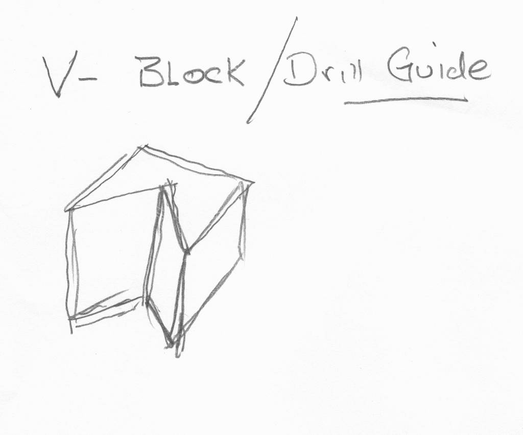

A simple method is to make a "V" block [if you have room]. You will need an accurat saw, preferrably a table say or band saw. Then you just use the "V" bolck as a guide for the drill bit. If you have an accurate miter box this will work ok.
Sorry for the poor quality sketch.
Gary
